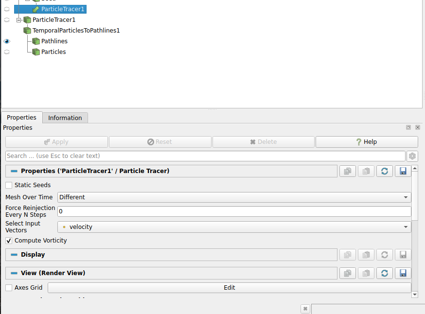

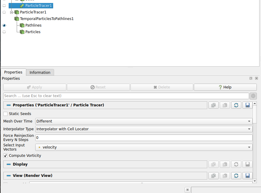

I tried doing it. Unfortunately, I can’t see where I can set Integrator-type like RK2 or RK4 and Step-Size. I have uploaded screenshots.
This is the ParticleTracer whic does not have these parameters exposed.
The StreamTracerWithCustomSource have them.
Oh, okay. Is there a way to set those parameters for ParticleTracer?
