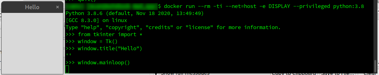

I built this on my local PC, running Fedora Linux, and using tkinter - it works out of the box.
However when I run it from the compiled downloaded version it doesn’t work. Even though the tkinter python libraries are available in the lib folder, the actual Tk and Tcl C libraries are not packaged with Paraview.
The only reason I have seen given is that because Paraview and pvpython share the code base it doesn’t make sense to provide a GUI library. However native python itself comes with tkinter support installed by default, and is supported from the command line.
