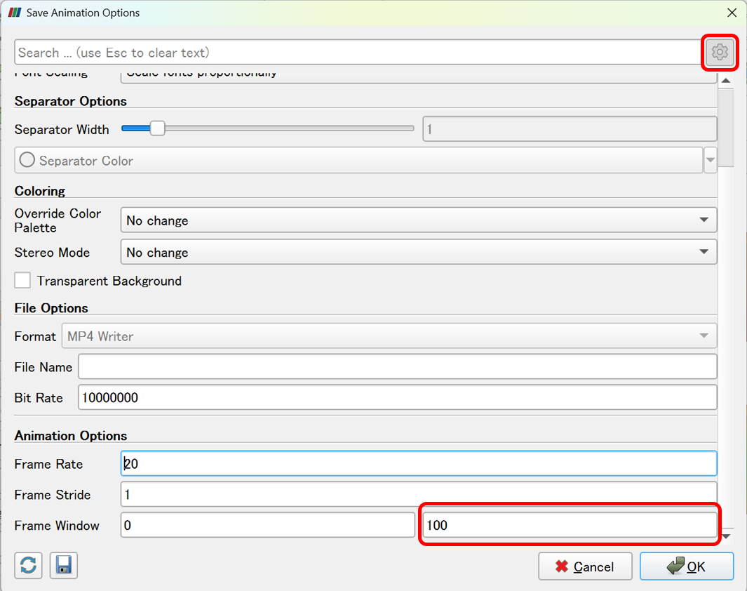

Are you entering the frame number set in Time Manager into the Frame Window under Animation Options in the advanced settings (gear icon enabled)?
I tested it and did not find any particular issues.
