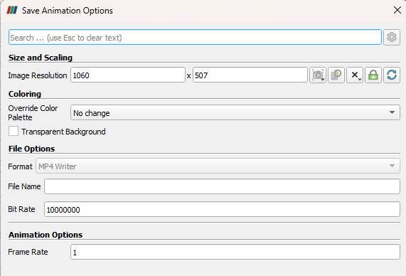

I used to be able to produce animations of a vibration mode. However I’m stuck now. This produces only a single frame: Why?
The playback is okay, I can see the animation, but the export produces just a single frame.

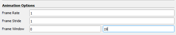

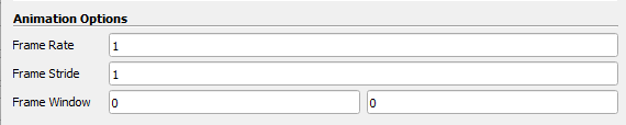

Edit: I figured it out. But it is bizarre: The default setting is
and I think one would be justified in thinking “this will export all frames”.
No, it has to be stated explicitly
Especially perplexing given that the default view of this dialogue is
so that the frame window is hidden.

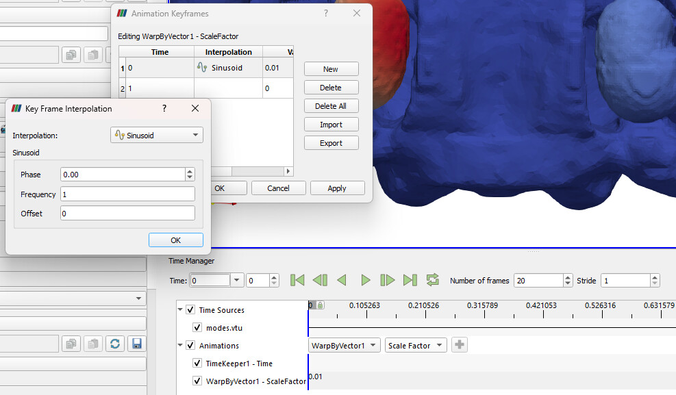

Also, for vibrations, you may find the Animate Modes filter may be what you are looking for.
