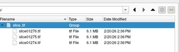

here are 3 slices of data: FileSender
You need to open them as a “group” (look a the green button in the top right corner)
Usually it is the way to say that each file match a timestep. But the tiff reader has a Read Images as Stack option that append them into a single 3D output.
