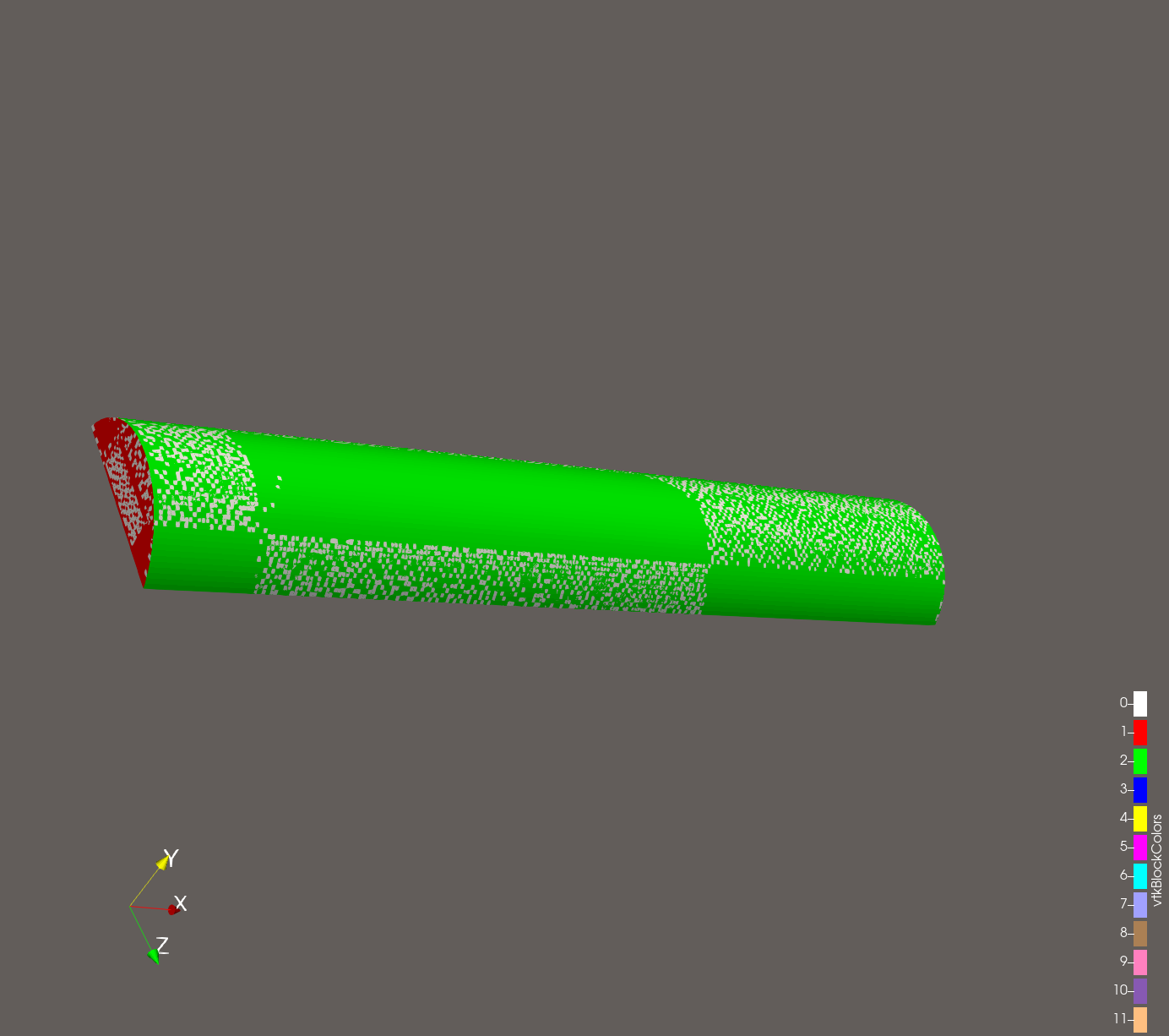

I can open forum.encas, it does not contains particles though:
Yes i can also open and it does not contain particles. But when i do the same in CFDPost it shows the particles. There is some confusion why this is the case?
I can only assume this is not supported by ParaView yet.
But on youtube i can see people doing particle tracks in Paraview..?
Of course, they use other formats. The formats you want to open cannot be opened in ParaView yet. Maybe you can convert to other formats but its more a question for Ansys.
