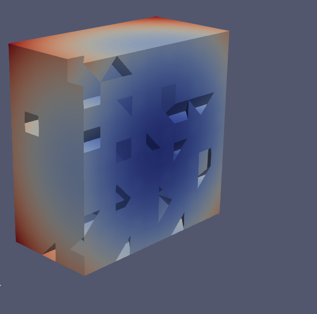

Using FEM software, I have my results saved into VTX files. I have learned that VTX stores data locally per process, which then results in problems when using clipping feature in Paraview. Specifically, some cells are missing after using clip filter. Problem occurs with “crinkle clip” unchecked.

Here is the archive of the vtx .bp folder. I use ADIOS2VTXReader, then clip filter.

Your dataset contains only lagrange tetrahedron, which are sadly not correctly supported by the Clip filter.
A work around is to use the Tetrahedralize filter first.

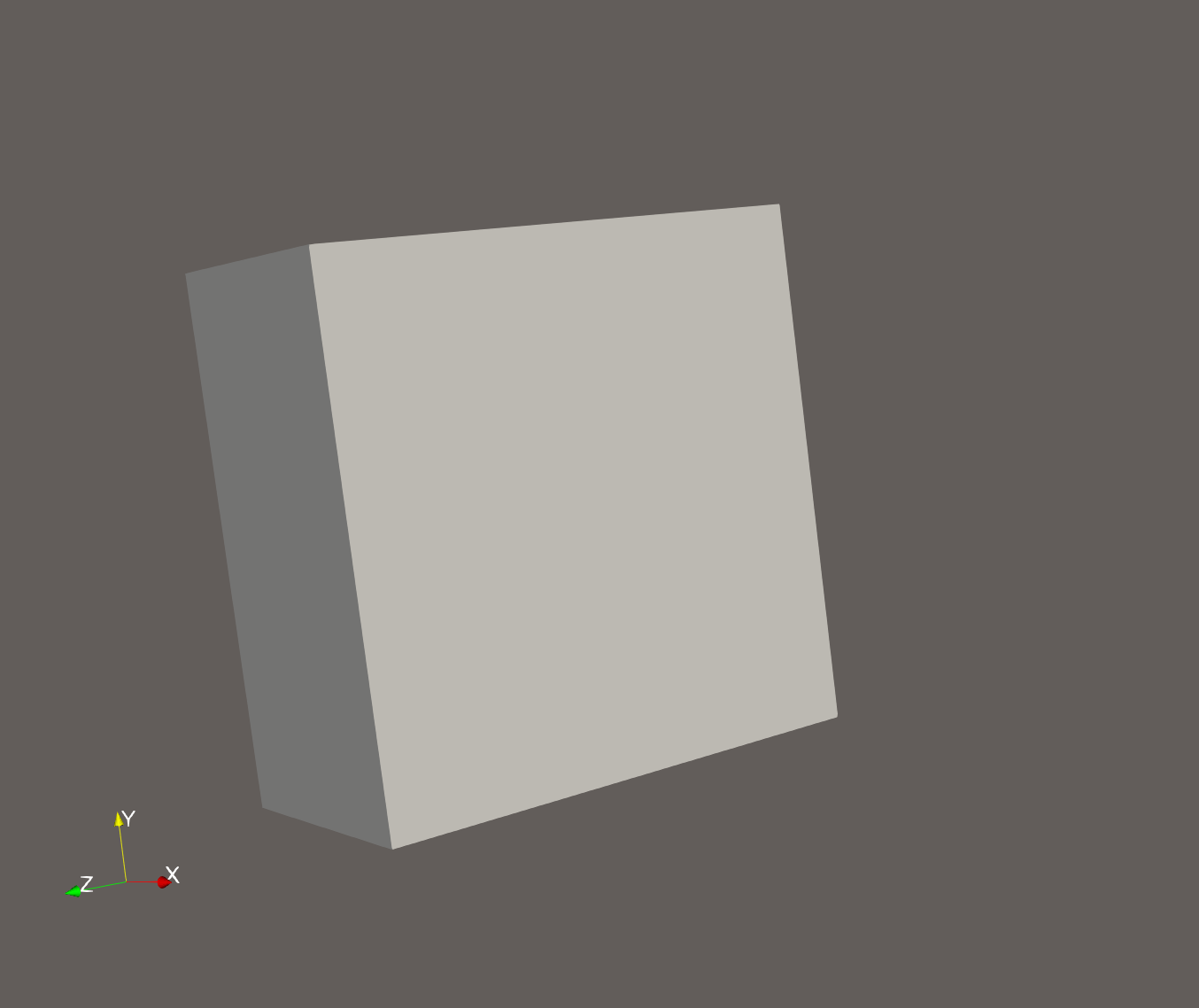

Thank you for the update. I forgot to say that when the VTX file is saved using only one process, the problem does not occur. Anyway, Tetrahedralize seems to be working well.
