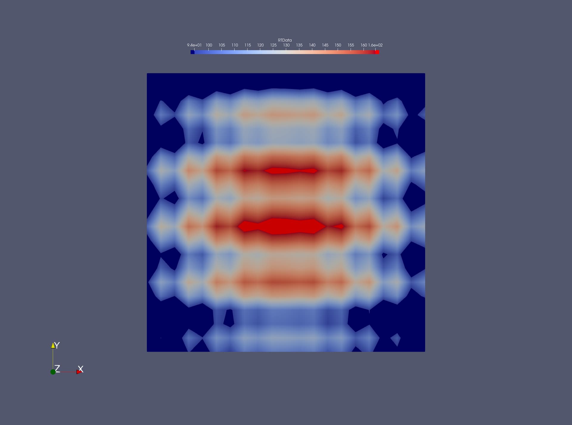

is there a way in ParaView to indicate the out-of-bounds values with a triangular arrow at the top and bottom of the colorbar after rescaling to a custom data range?
I am looking for something similar to the extend=‘both’ property in Python - cf. with the example below:
grafik
Is this what you are looking for ?
Available in the color map editor advanced options, AboveRangeColor, BelowRangeColor.
Best,
Thank you!
That’s what I was searching for (even though I personally prefer a triangular shape).
