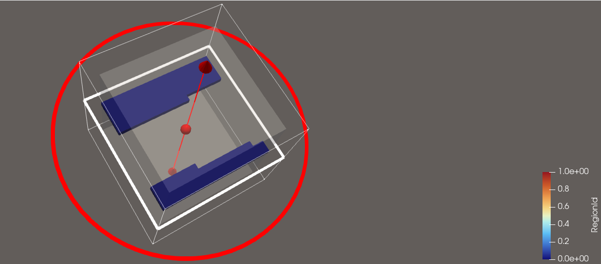

image of the original wavelet (transparent) and the extracted cells from the selection after second connectivity filter (ie., final result) and it can be seen the two clearly separated regions shows like only one region. (i imagine that it comes from the original connetivity? as if i change the input of the extract selection to the wavelet instead of the connectivity filter this gets as expected, two regions)
@mwestphal could you confirm me if it is a bug or intended use case? so i create an issue if it is a bug. thanks in advance.

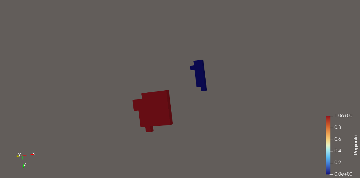

Unable to reproduce:
extract.pvsm (715.4 KB)
here you can see what I mentionned (in the regionId for cells only), paraview 6.0.1
example.pvsm (590.4 KB)
In your extract i see exactly the same, it is for the cell regionId not the point regionId
Confirmed, this is a bug, you can fix it by removing the cell data using PassArray.
Anyway, please open an issue.
