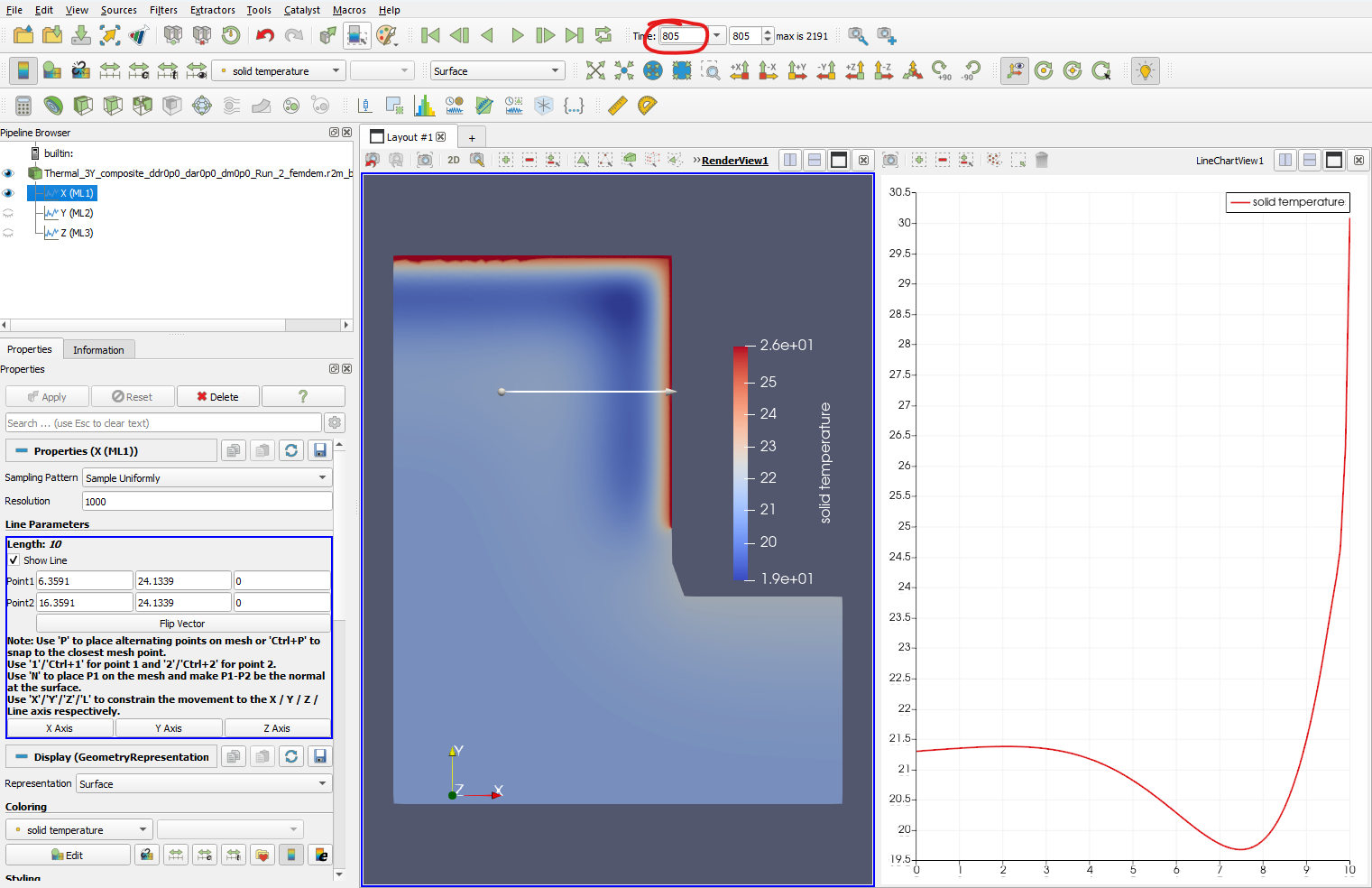

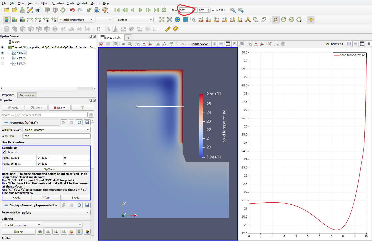

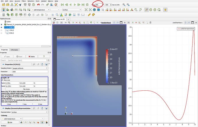

The simulation contains 2,191 time steps. From the overall results, there doesn’t seem to be any issue when advancing from step 805 to 807:
Step 805
Step 806
Step 807

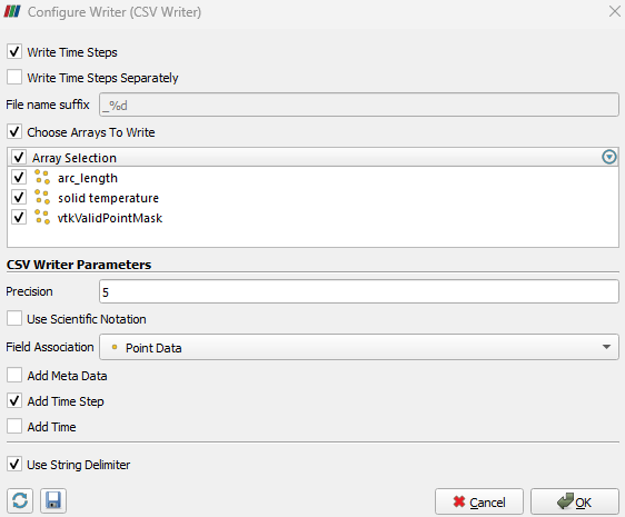

These are the settings I’m using for saving:
