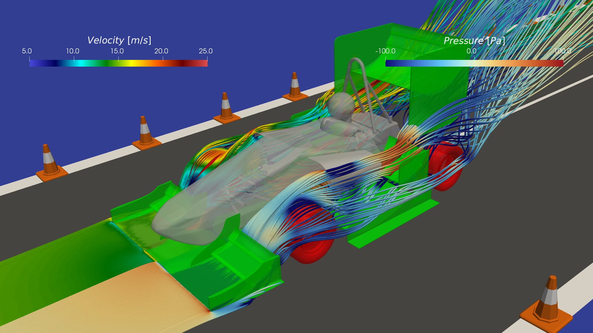

And it works fine:

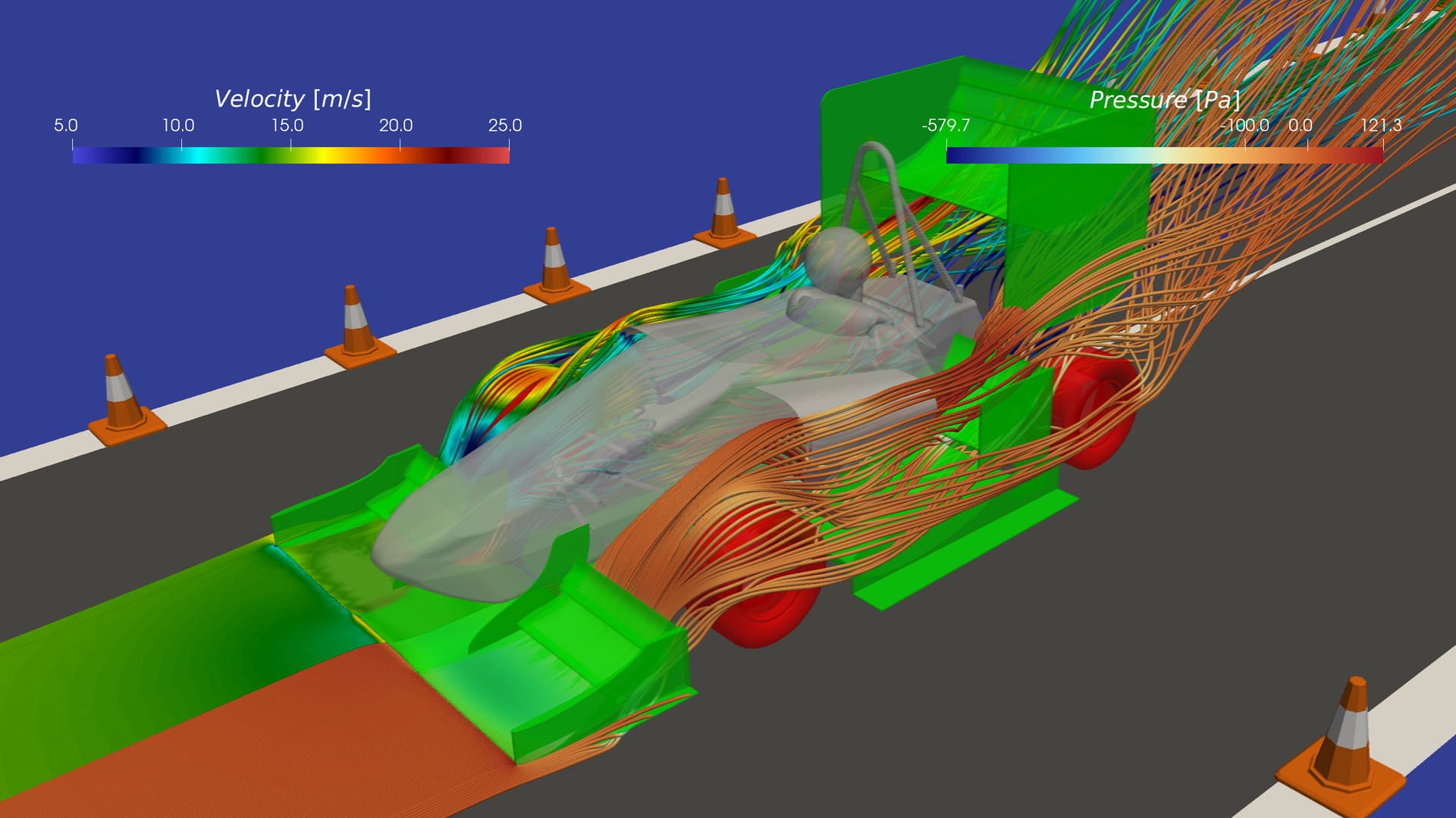

But then I hide them to manage other elements in the scene and when I display them, the velocity display is fine but the pressure contour has changed its range:

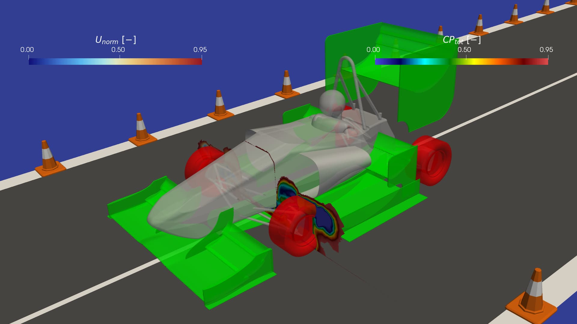

It should look like this:

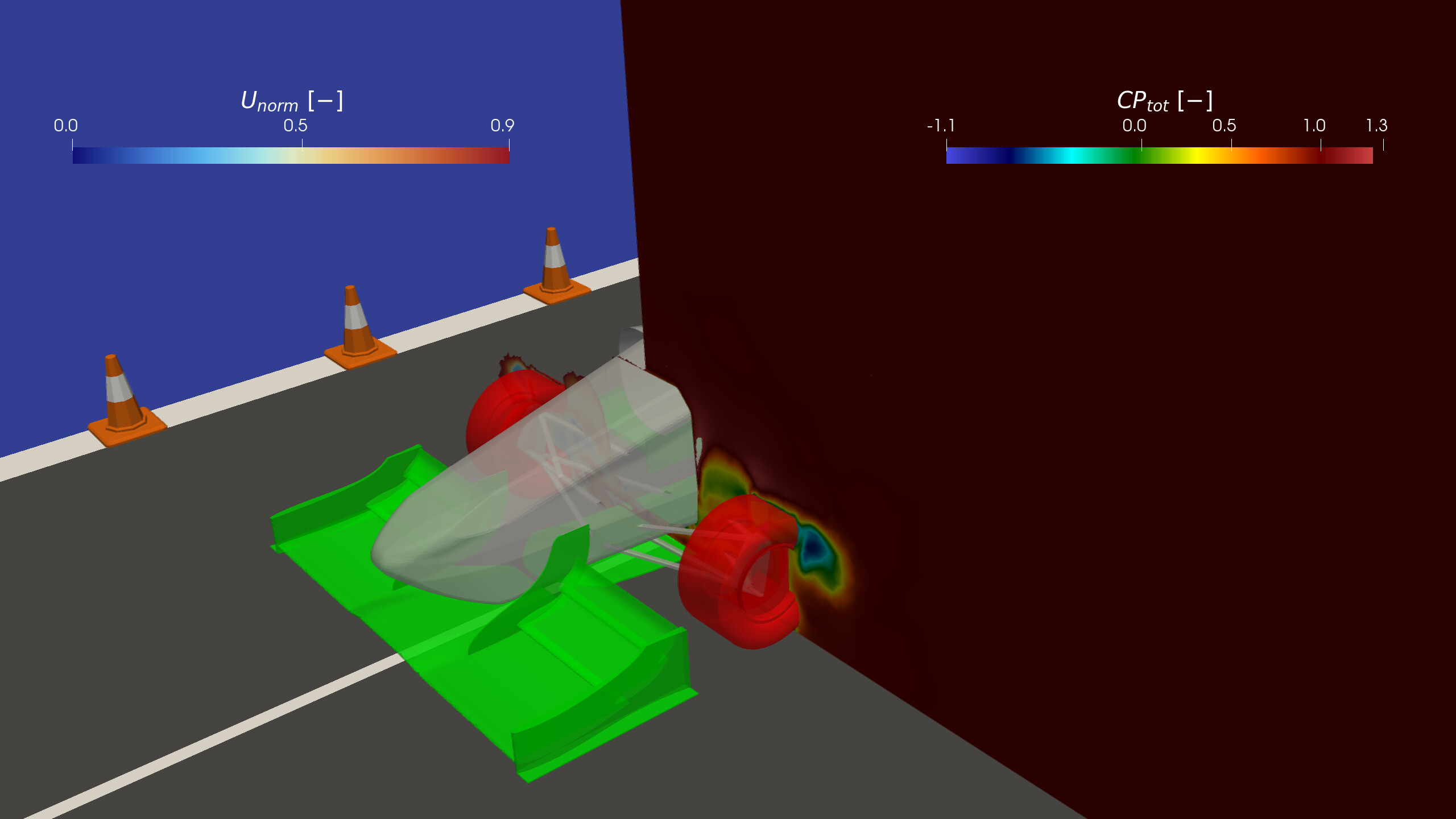

But it looks like this after hidind and showing it:
