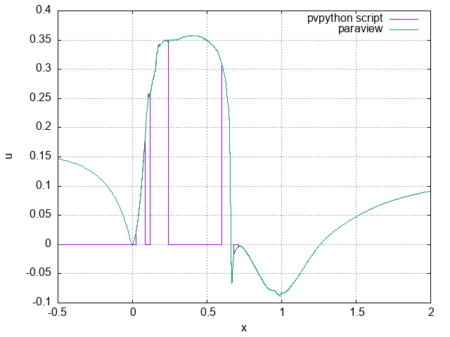

The dataset linked below has a state file in which I resample one dataset with another. It also includes a pvpython script that I expect to do the same thing but doesn’t. In the plot below, you can see that the script version fails to find some of the points and assigns VelocityX a value of 0 at those points. What’s the difference between what I’m doing in the GUI and what I’m doing in the script?

It appears to be a tolerance issue, perhaps because this is 2D data. I can get the same result from my script as I get from the GUI if I call SetComputeTolerance(False) on the resampling filter. I don’t explicitly set a tolerance, and the default tolerance appears to be 1.0.

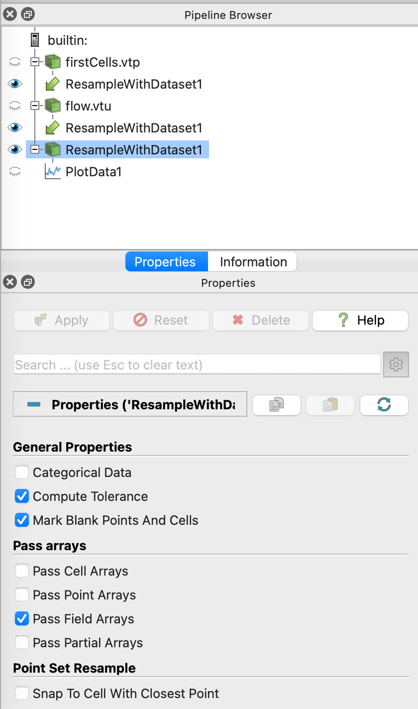

I’m talking about the vtkResampleWithDataSet filter. When I do my resampling in the ParaView GUI, I have a pipeline that looks like this:
This works, and I can get valid data at all sampling points, regardless of whether I check Compute Tolerance.
