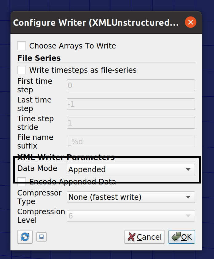

If you just want to decode the data, open the file with ParaView and then save it again by setting the Data Mode to Ascii instead of Appended. See below
