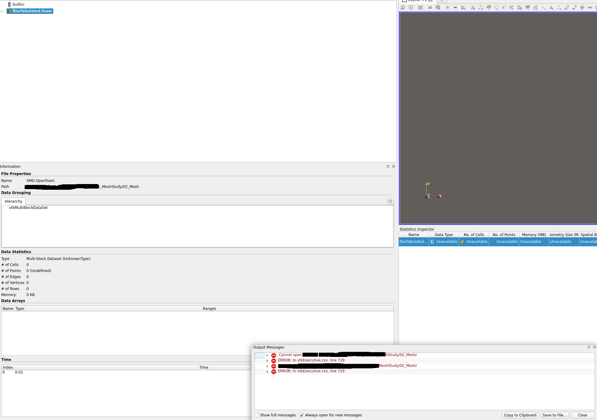

As a debugging step, I deleted the “wrong” case file that ParaView kept trying to load. Now, when I try to open any .foam case, ParaView 6.0.1 immediately throws an error, as it’s still trying (and failing) to find that now-deleted file.

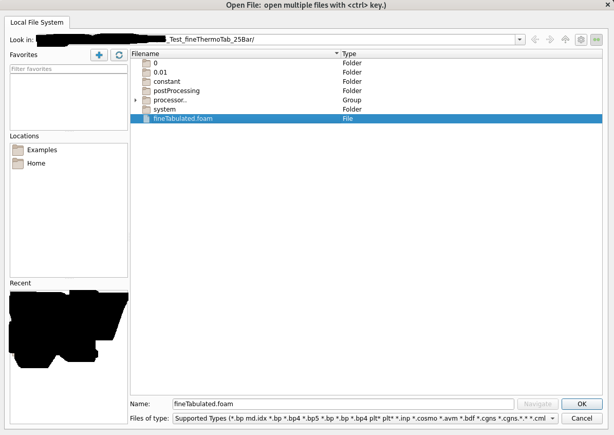

I’ve attached two screenshots(i blurred the filepaths):
  1. The first shows the file I am actually selecting in the “Open File” dialog.
  2. The second shows the resulting (and incorrect) data/error in the ParaView pipeline.

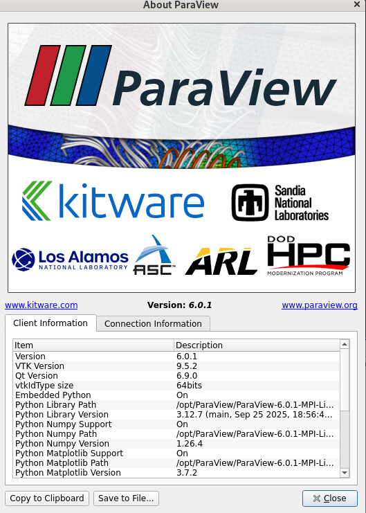

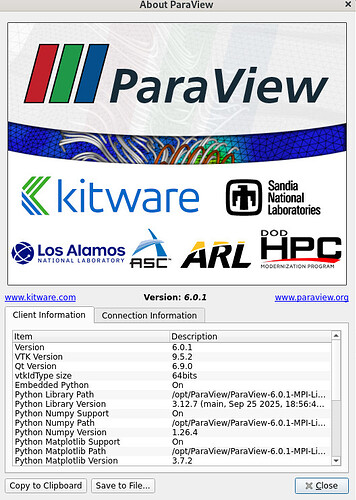

This is fixed in ParaView 6.0.1, please make sure this is the version you are using.
I am using 6.0.1
I just checked with 6.0.1 and the settings is not saved for me:

To be honest at this point I’m very confused about what is happening. How did you build/install ParaView ?
just unpacked the paraview zip into opt/ParaView. im also confused … Older version of Paraview just work fine
From paraview.org/download ?
yes !
