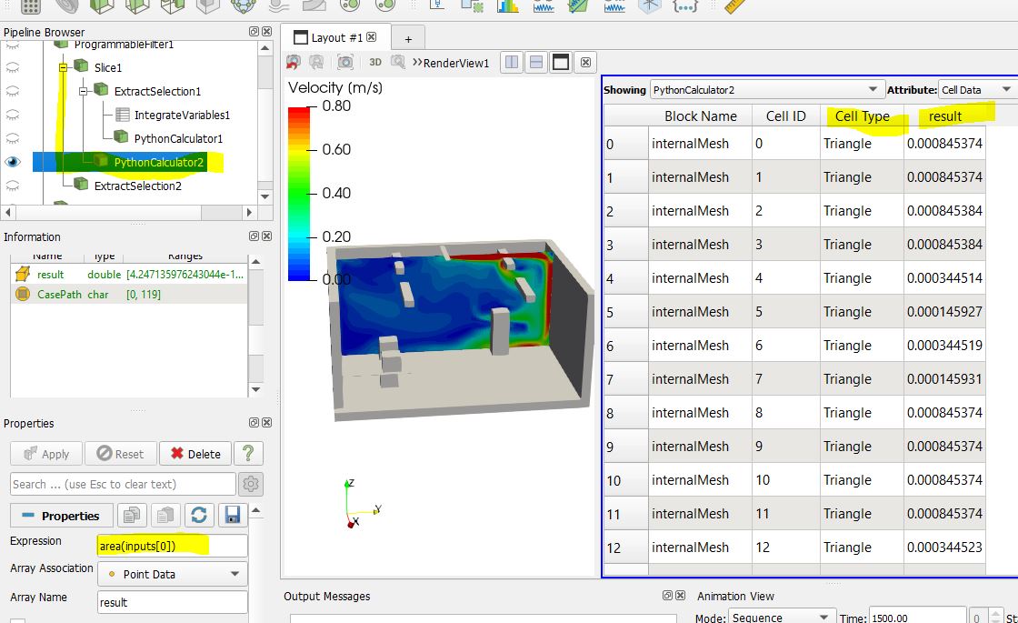

I have a slice which i use extract selection to get the desired output. When i use the integrate filter on it all variables will get the value 0 and i dont how to fix that. The interesting thing is, when i use a python calculator to get the area of the values i get that: Area = -1 , Cell Type = Vertex
When i use the integrate variables filter directly on the slice it works. As you can see when i use also a python calculator to get the Area. Area has values, and Cell Type = Triangle
I guess it has something to do with that area = -1 and the Cell Type. Any ideas if this beaviour is intendet and how to get the integrated values out of an extraction? Thank you very much.
