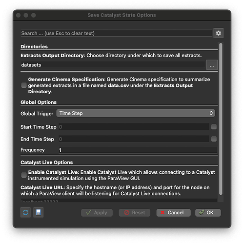

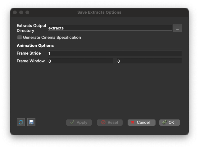

Assuming you are doing this in the UI, if you use File → Save Extracts, you set the directory with the Extracts Output Directory property in the Save Extracts Options dialog:

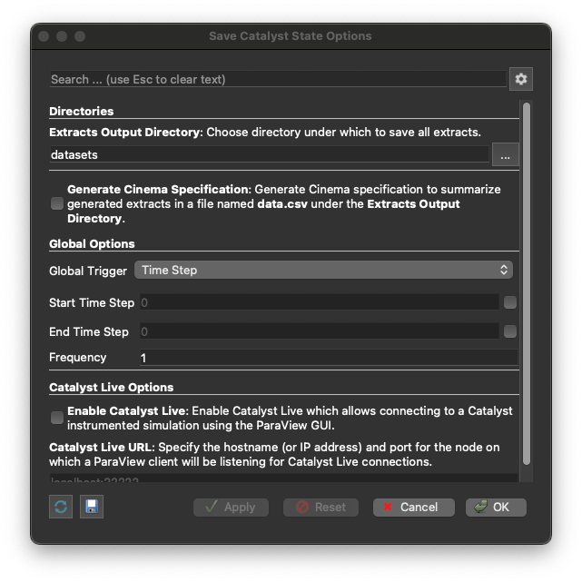

If you use File → Save Catalyst State, you set the directory with a property with the same name in the Save Catalyst State Options dialog:
