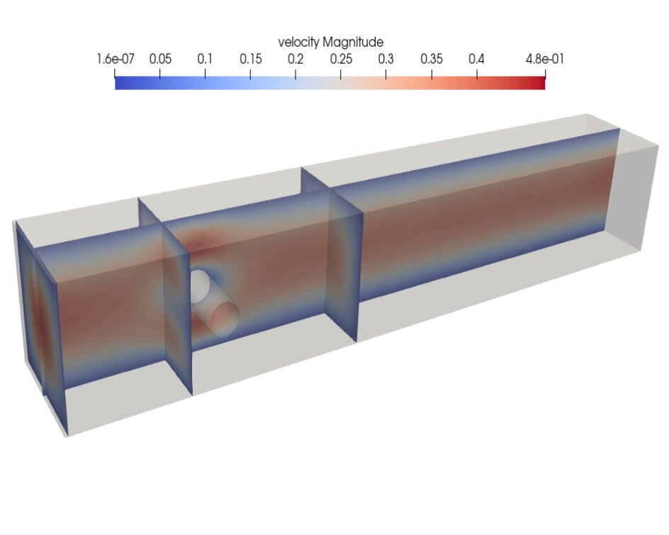

Hello everyone
I want to plot such a side view plot for velocity. How I can plot it in paraview ? The side of pvd file is more than 4mb. I can’t able to upload it. Help me in plotting this side view or top view.

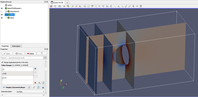

You can use two Slice filters with multiple slice planes (added using the Value Range table in advanced properties) to achieve such an effect.

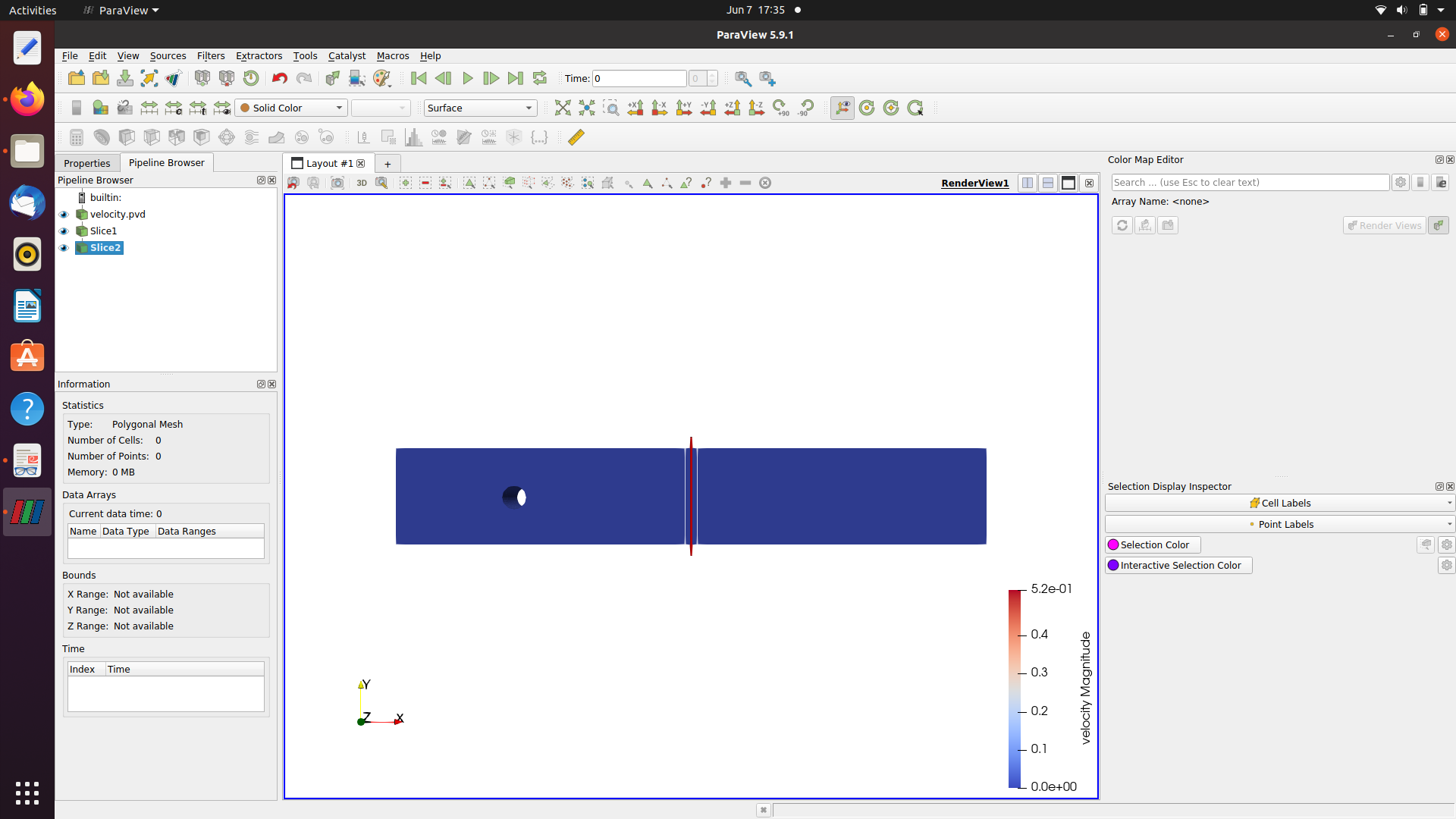

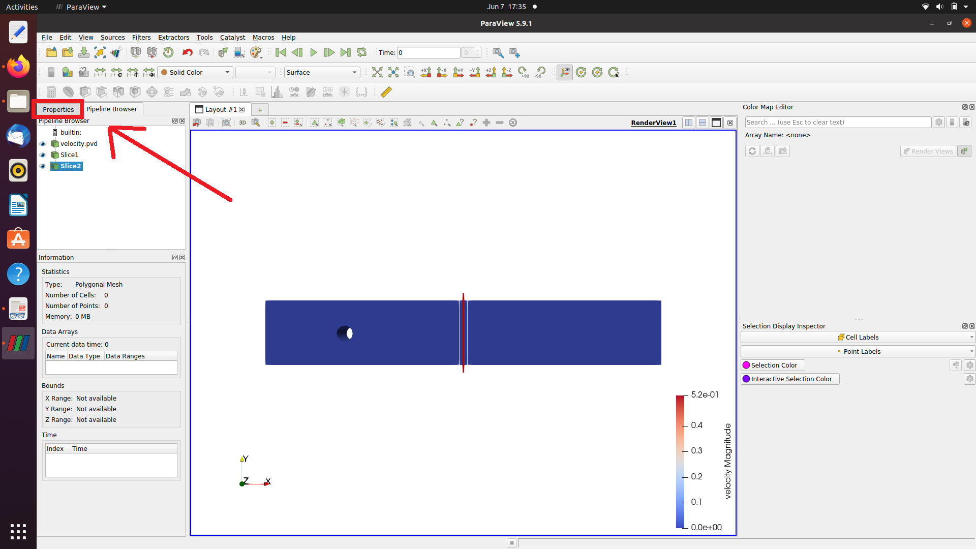

It’s in advanced settings (button with gear symbol) in the Properties tab.
not able to found anything in the properties tab ? sorry to trouble you. I tried to found out.
In your case, the Properties tab is here:
and it should contain the filter options once it’s selected in the tree.

How you do this ? I am not able to do. Please guide me.
I want same plot.
I attached the file that you can open to see this plot in ParaView.

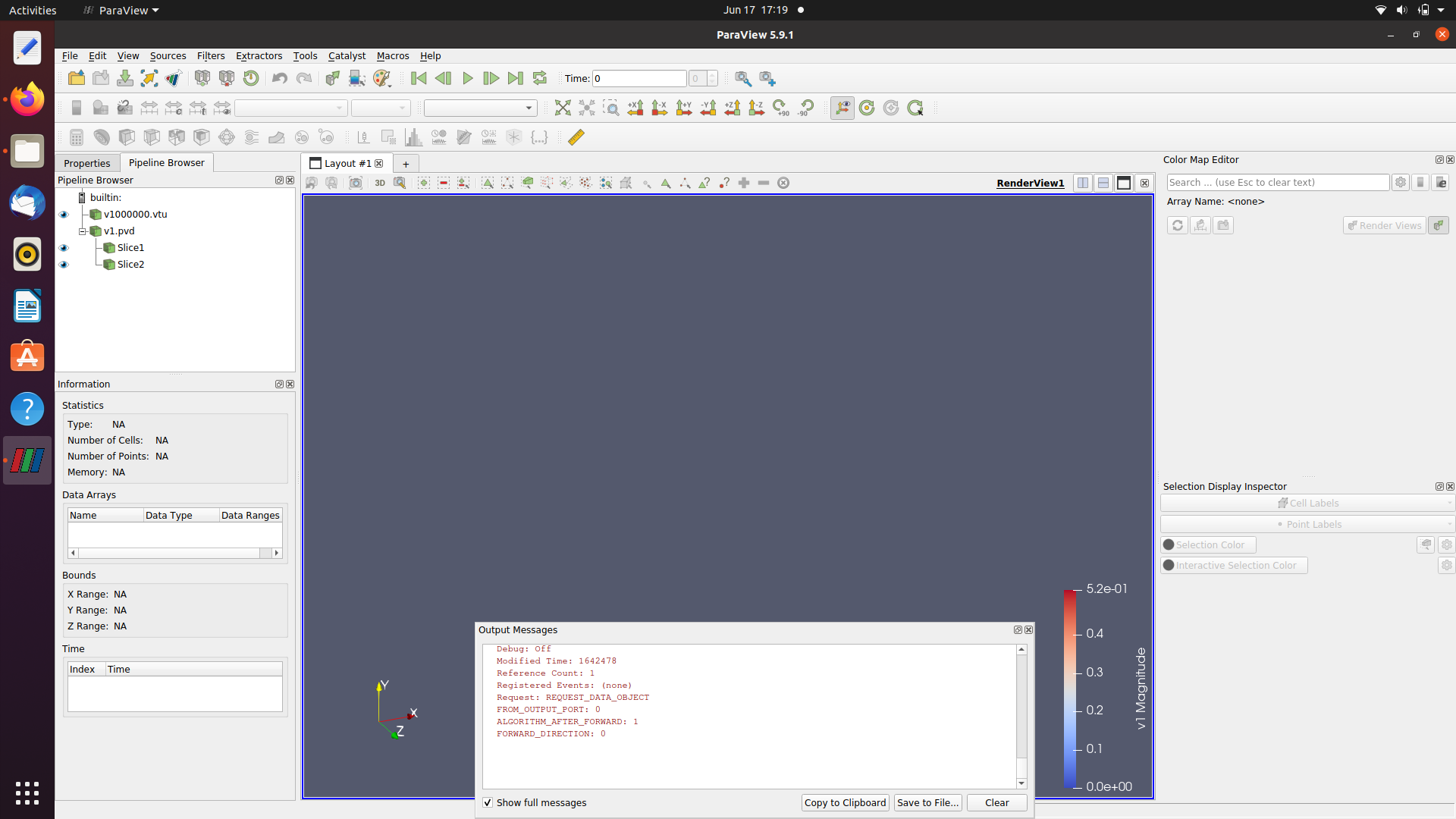

I am not able to open this plot in paraview. I want to plot for different parameters that’s why i want to know How you plot it ?
To open this .pvsm file, use File → Load State. You will be asked for file names/directories and you can either let it locate the data automatically or manually select the data files if the first option doesn’t work properly.
