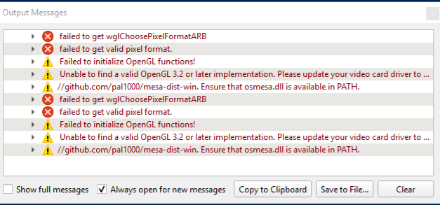

I recently updated the drivers for the NVidia GPU on our workstation as it was required for the DualSphysics solver. But since then Paraview fails to launch (worked fine before). Updating to v6.0.0 did not solve it.
When attempting to start the program following message box is shown briefly:
I tried to find answers online, but wasn’t able to resolve the issue. Perhaps someone here has a better view on the problem.

In short, ParaView is unable to use your OpenGL libraries because they miss a critical entry point.
Can you share your GPU model, driver specifications and version ?
Sure. It’s an NVIDIA A10 GPU, driver version 539.41 (type DCH), 24GB GDDR6 video memory

Well, you updated your graphic driver and it broke ParaView rendering, so the cause is the driver update and there isnt much ParaView can do to alleviate that.
