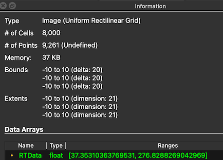

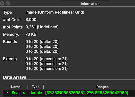

The Wavelet source produces a vtkImageData with floats, and this programmable script casts that image to a vtkImageData of doubles.
Input image info:
Output image info (note the array type is “double” instead of “float”):
It’s maybe not the most useful example, but it demonstrates that ITK can be used within ParaView’s Python environment using virtual environments and a pip-installed ITK.
