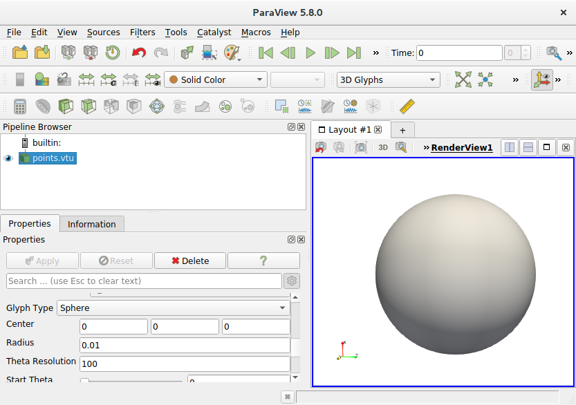

However, setting the radius to any value lower than approximately 0.009129475239 has the sphere disappear.
How can I make these glyphs show with a smaller radius?
A colleague of mine experiences the same issue with Paraview 5.6.0, but using the Glyph filter he is able to visualize the grid points as spheres of any size (after setting the Scale Factor to 1):
However, if I run the trace code that my colleague generated with Paraview 5.6 in Paraview 5.8.0, the spheres do show and remain visible when I change their radius. tiny_sphere_paraview56.py (6.7 KB)
