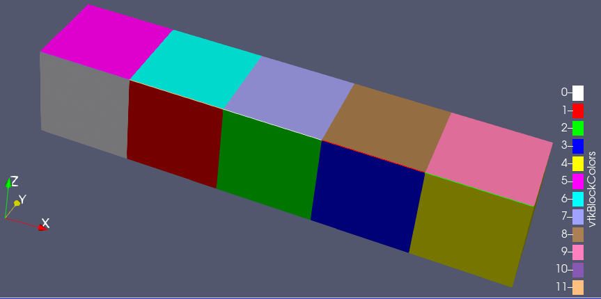

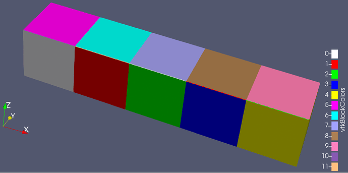

Please find attached an exodus model consisting of an array on blocks. The blocks get activated/deactivated over time and are assigned to two groups: “OddVolumes” and “EvenVolumes” (via eb_prop2 and eb_prop3).
BinaryBlocks.7z (355.0 KB)
Indeed, these properties do not seem to be read by ParaView as far as I can tell.
Thanks for checking. But due to the fact Paraview is currently not supporting groups, there is also no point in reading them.
As I said, they could be read as data and be used in ParaView for coloring, selection and extraction.
