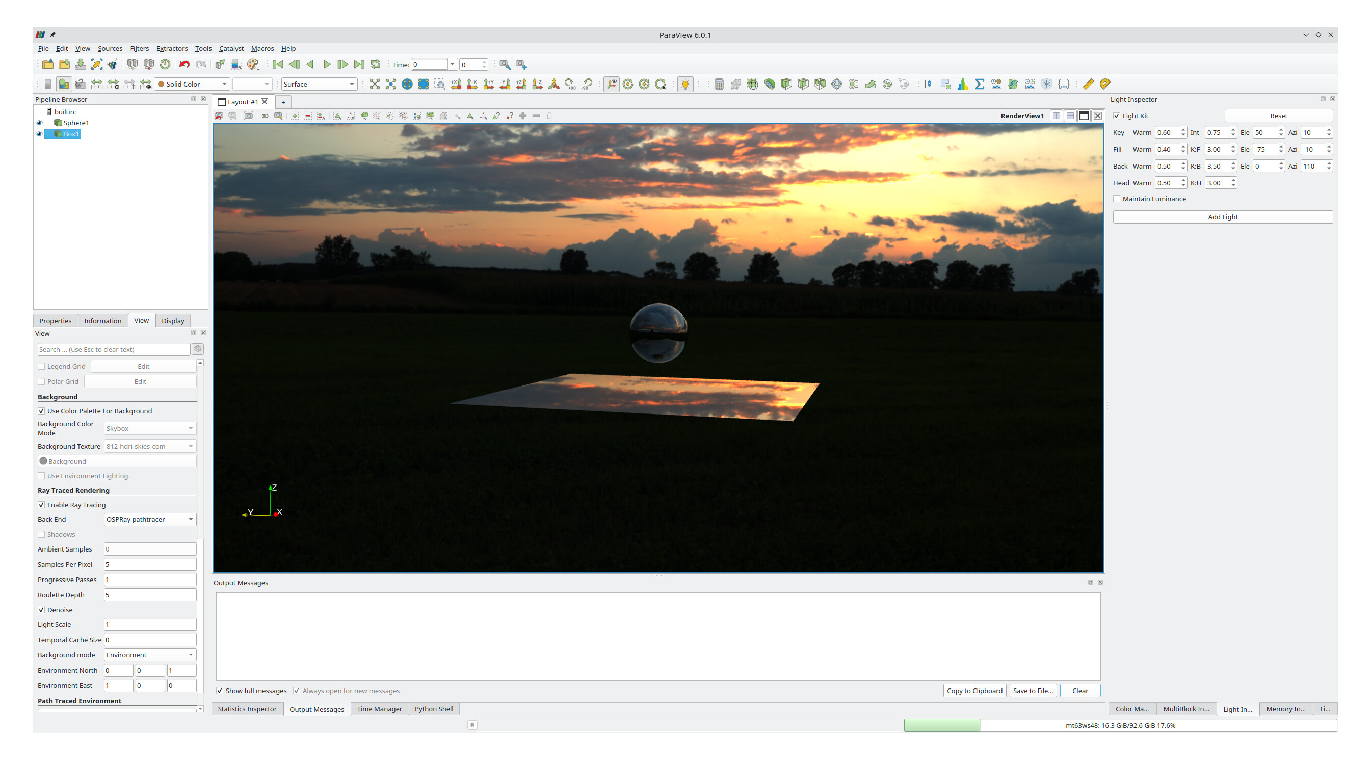

I am on Paraview 6.0.1 and when I load a HDRI and enable it as Environment with OSPRay, the scene is very dark and the background HDRI is also very dark.

And this is what it looks like in Paraview with OPSRay on:

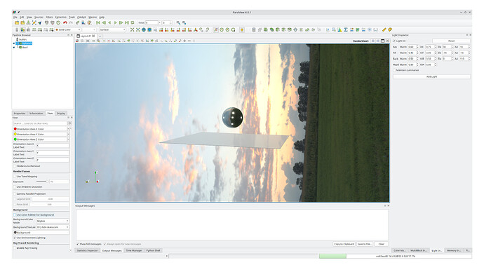

When I use PBR with the Skybox instead, the background image looks better, although it is still a bit too dark.
Dark is not the best word because the colours are shifted, noon is actually turned into a sunset.
I confirm the behavior, that OSPRay rendering with HDRI is darker that it should be. Please open an issue.
