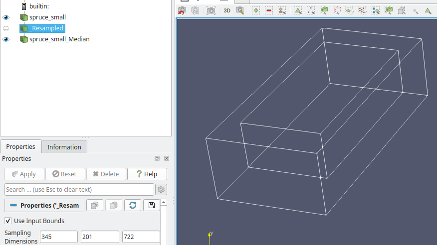

I have a tiff image of a 3D scan that i am trying to use paraview for the extraction of surfaces meshes.
currently, i have the data with a space of 1 length voxel, i wanted to sub divide each voxel by a factor (sub divide each cell). once the data is subdivided apply a median filter to ‘clean’ a little bit the data for after applying thresholds etc.

  • import the tiff image → get the number of voxels in each direction using .GetBounds()
  • use resample to image filter and in sampling dimensions use the values of the GetBounds() * factor of refinement→this will give the ‘same’ tiff image but with smaller voxels
  • use median filter over the resampled data
with this workflow, i am getting a result that is larger in total volume? (the result of the median scales up in volume inversely to cell length i get when using the resample, just to notice also, the _Resampled looks the same in total size than the spruce_small filter (original tiff reading filter) the scaling comes when the median is applied)

@mwestphal sorry for the tag, no need to adresse the post itself, but could you confirm that is inteded that if the spacing is different to 1, the median will output a different volume? as if it was scaled up/down? i find it strange and i am asking myself if it is a bug or not.
Im afraid Im not following, please share some data to reproduce.
the data is here: FileSender
if one use resampling to reduce the size of the pixels, ie., cut them by 2 in each direction, when the median is applied, it increase the total volume.
I reproduce, it looks like the median filter completely ignore the extent of the image data and only considers dimensions.
Please open an issue.
