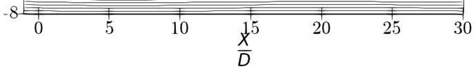

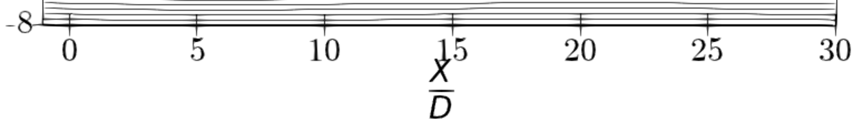

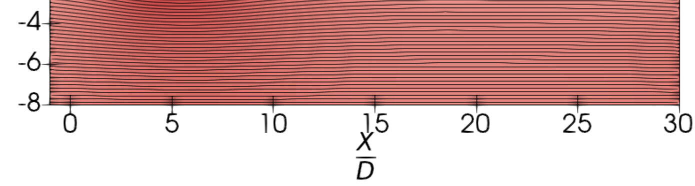

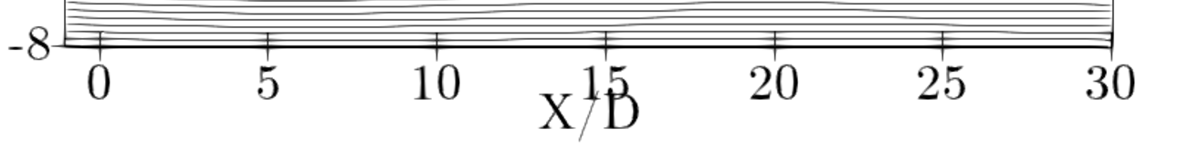

Here are a couple of images that show what’s wrong:
I want to increase the distance between the grid numbers and the label (X/D). I could, of course, create specific bounds to avoid this issue, but I simply don’t want to.
