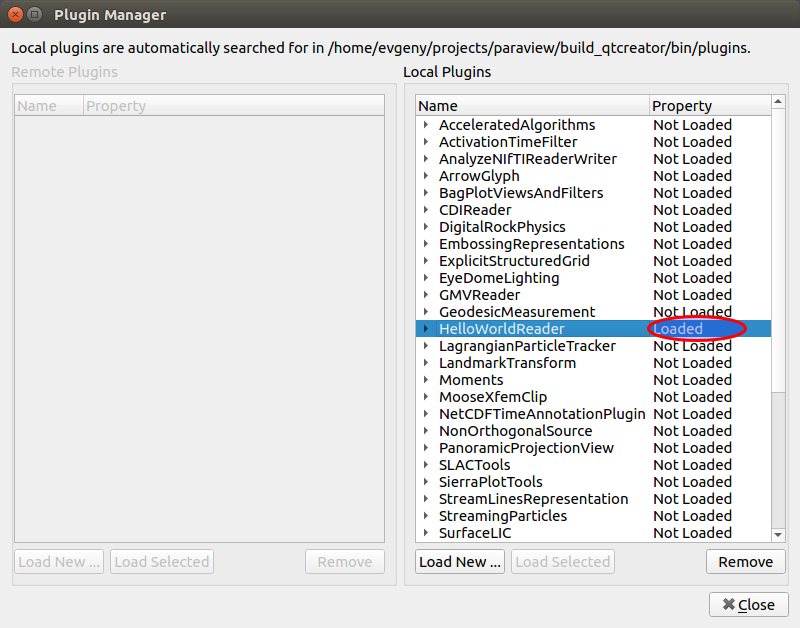

I read the instruction https://www.paraview.org/Wiki/ParaView/Plugin_HowTo and build a simple HelloWorldRedaer but it doesn’t work. It load a dynamic library but can’t apply a HelloWorldReader reader.

This fixes ParaView’s module loading so that it can work: https://gitlab.kitware.com/paraview/paraview/merge_requests/3308. For your plugin, changing it to be an actual package (I did HelloWorldReader/{__init__.py,hello_world_reader.py}), it now loads properly. However, I don’t know how to actually use the plugin to get the proxy to show up in the File > Open dialog. @mwestphal@utkarsh.ayachit Any ideas?
