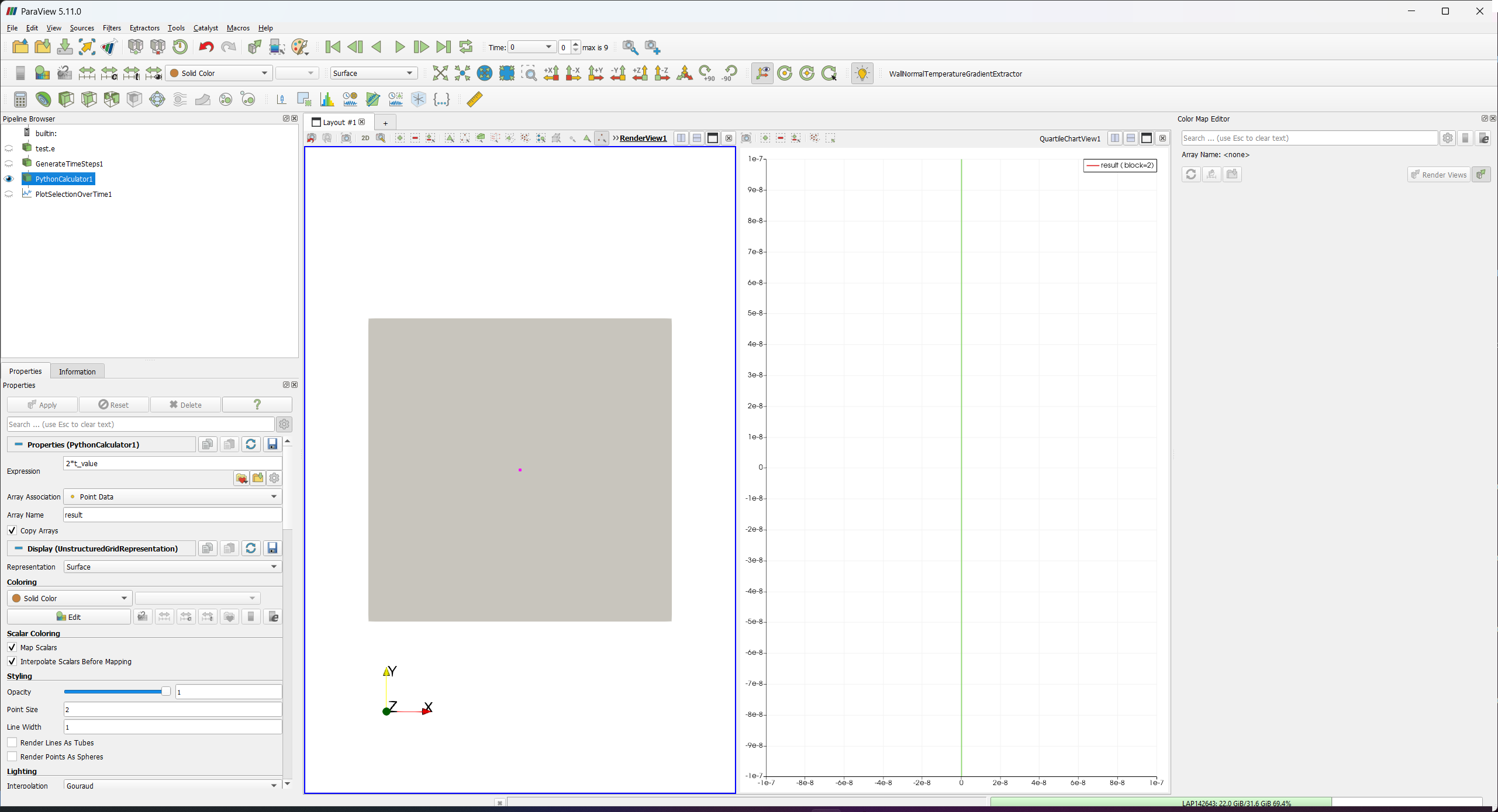

On windows:

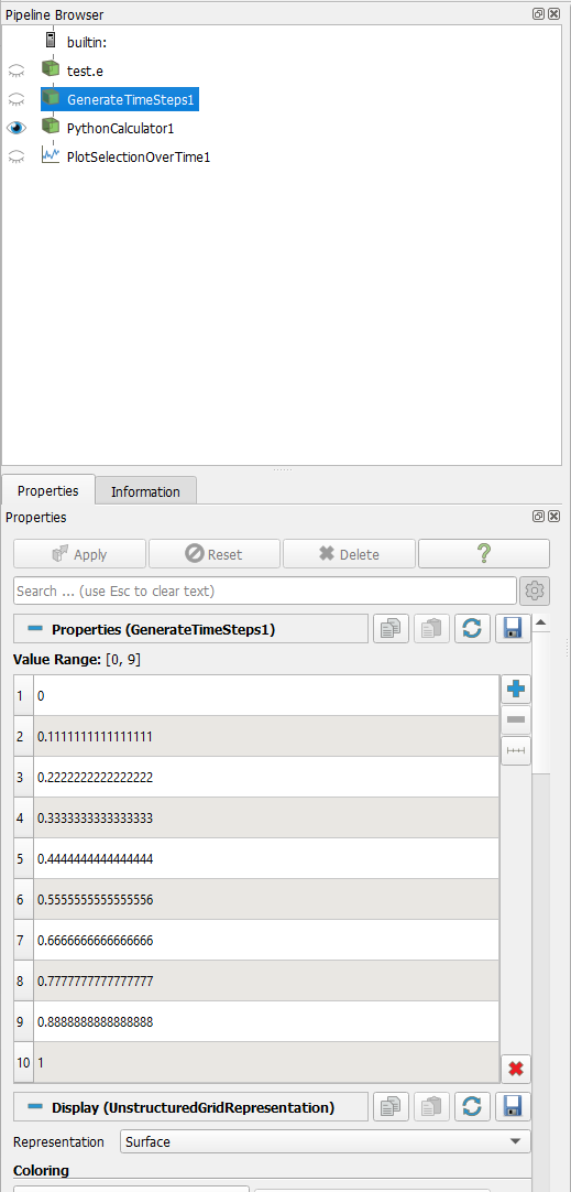

This is Generate Time Steps filter:

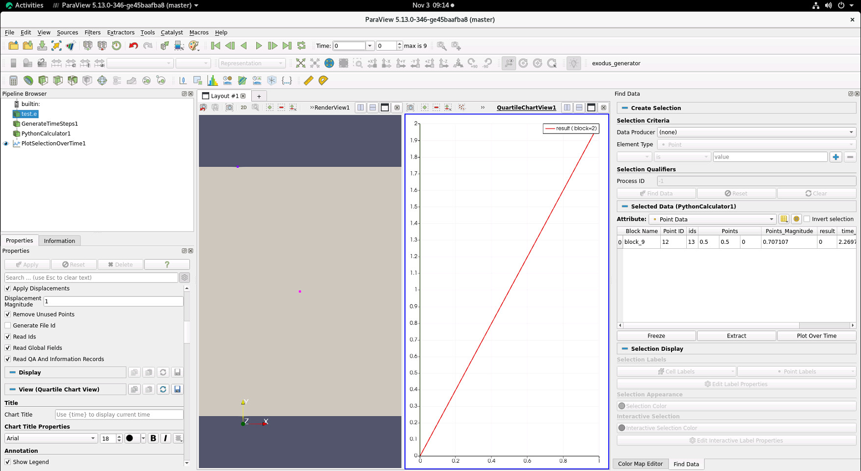

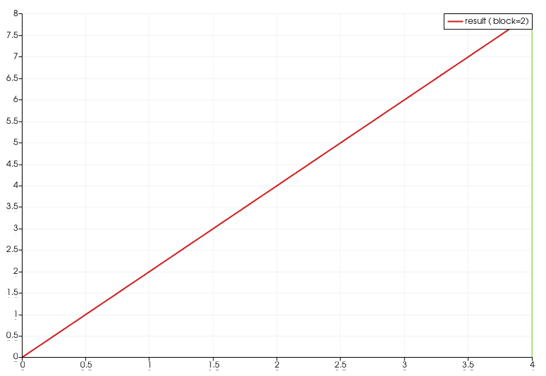

When I repeated the exact same procedures on a linux machine, this is what I get:
The plot is correct. It is not just plotting issue because I tried to save the data in exodus format on both machine and, in linux, everything was expected while, in Windows, the exported file did not have any data in it.
