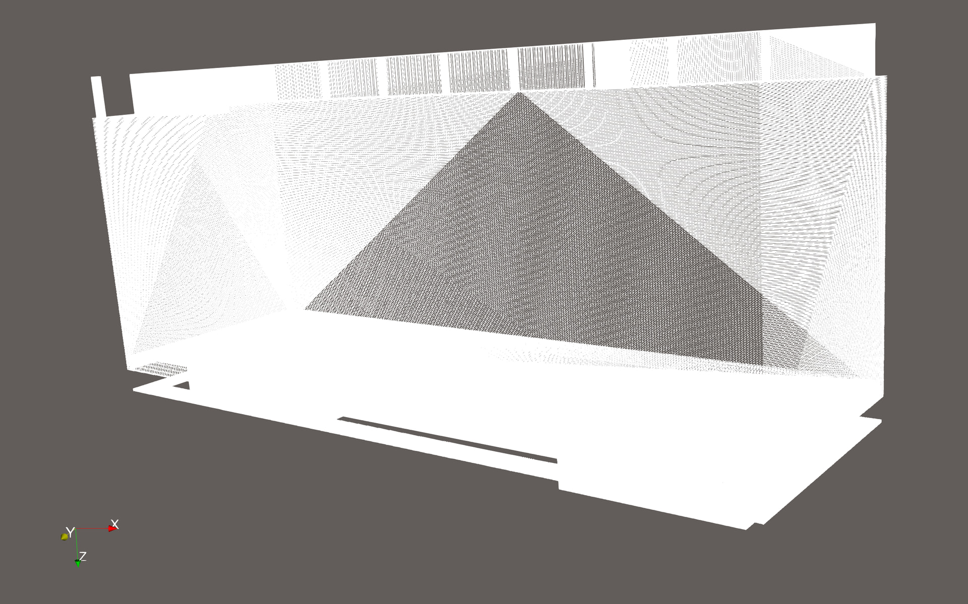

thanks for your answer. But I would like to generate points on the model with complex surfaces, i.e.
3d model_EHQ Admin paraview.stl (29.0 KB)
Could I ask you to recommend me any solution?
thanks
Peter
Use “Subdivide” and “ConvertToPointCloud”:
