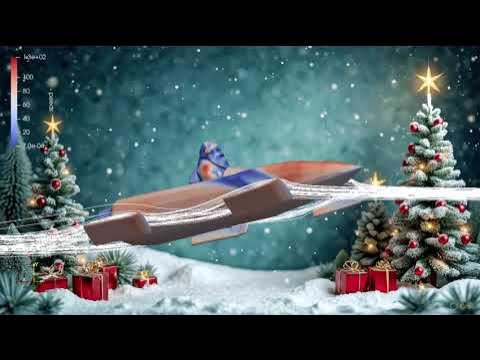

Im loading an image into the background, but the image colours are getting changed by the legend colourmap. I just want to create an orbit of my geometry with contours of velocity on the surface, but with a nice background. How to import an image without screwing up the colours please?

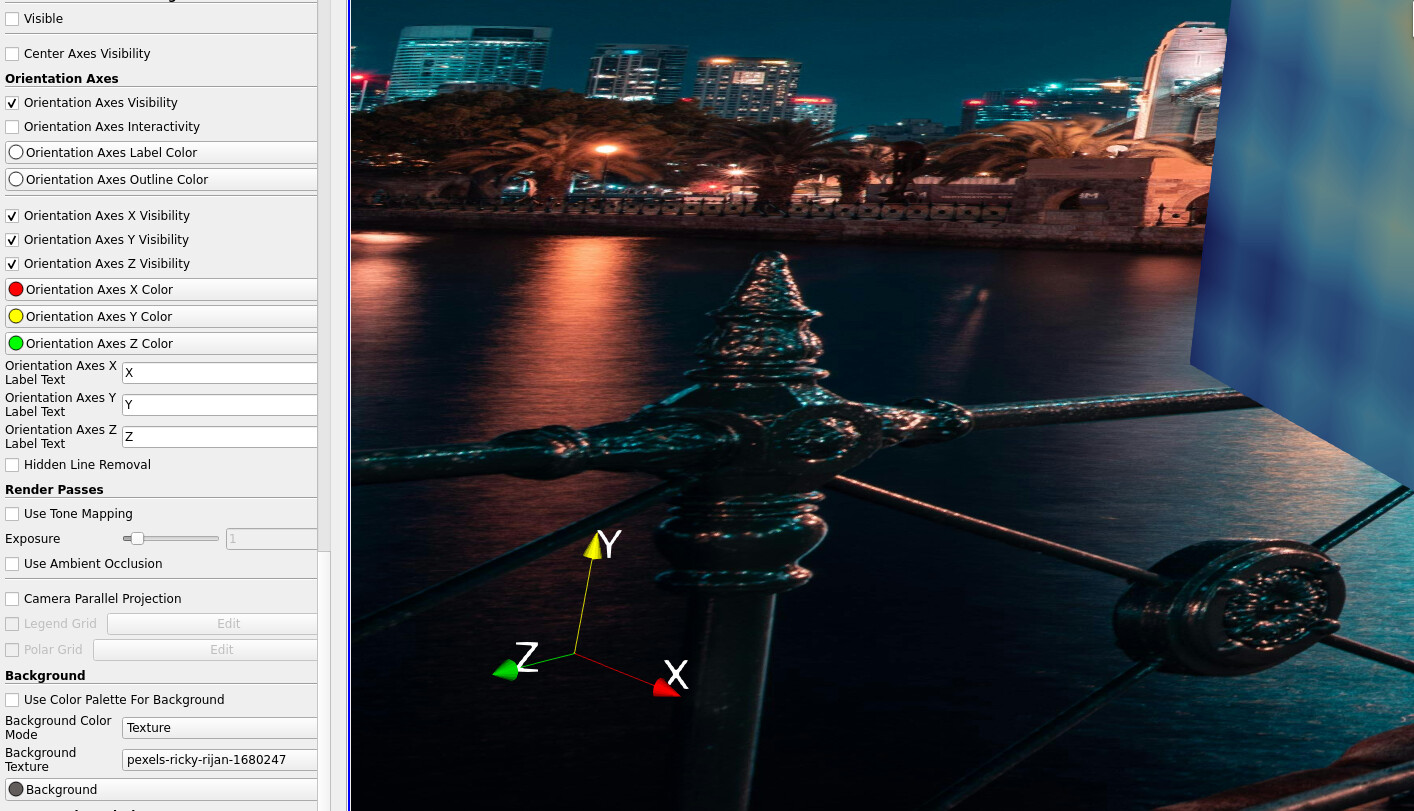

Use a proper background:
Thanks Mat - that was much easier than I expected ! :smile:

I love it :slight_smile:
