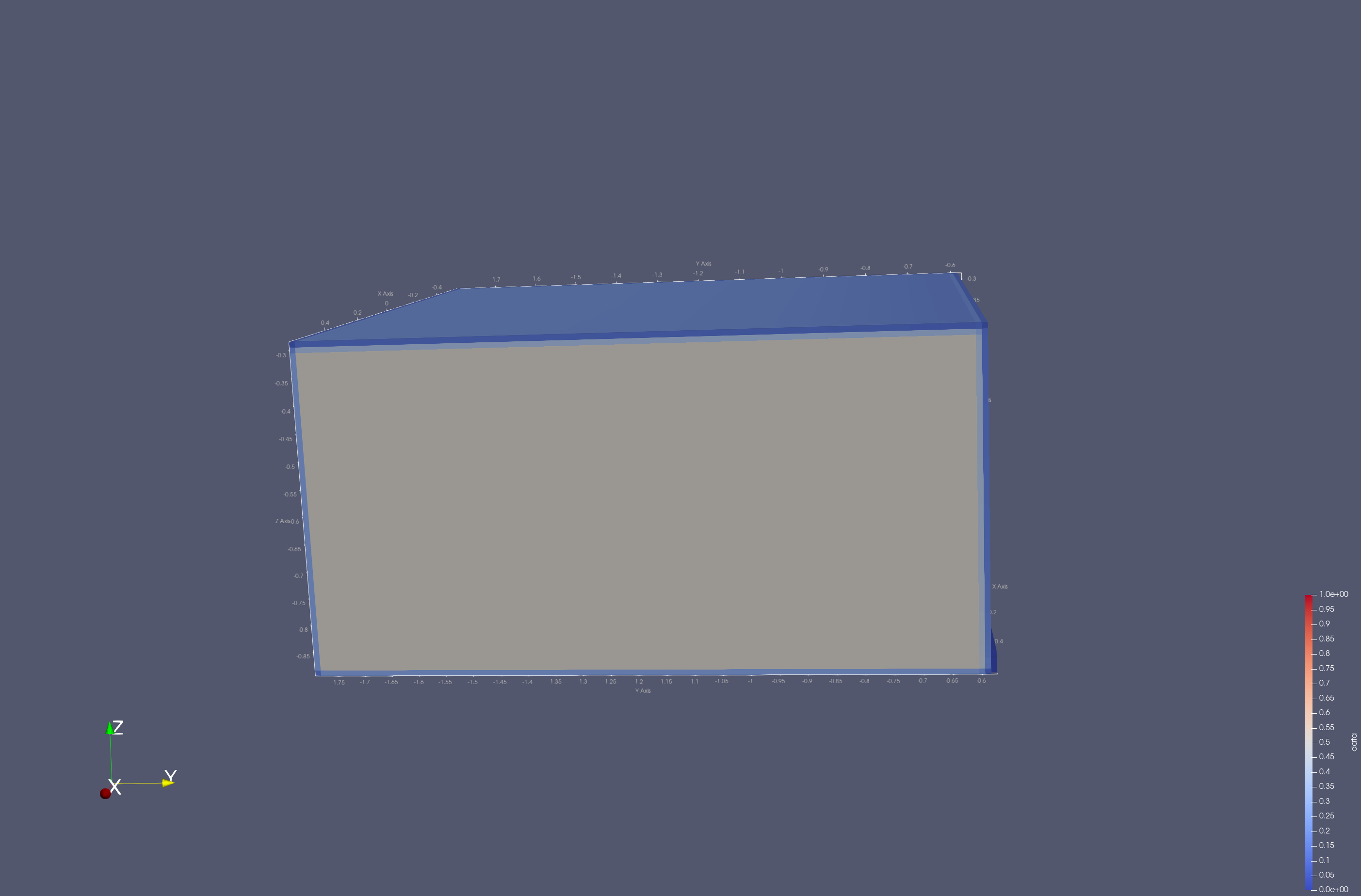

I set the display of axes grid in my case, but the output result is not very satisfactory. I want to reset the coordinates to the boundary intersection point. May I ask how I can achieve it? Or what methods can achieve the same effect?

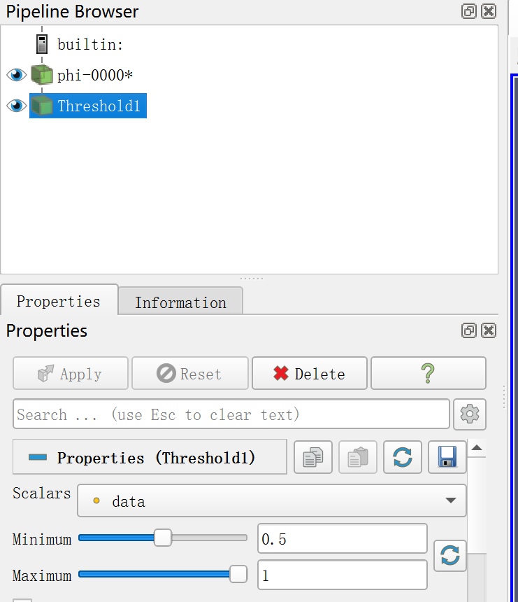

Here is my set.
Hide the “phi-000” to fix the issue
I output these data through a software, but I am not familiar with internal operations. I want to achieve the following effect by changing the coordinate origin. Can I achieve this?
Hide the “phi-000” to fix the issue by clicking on the “eye”

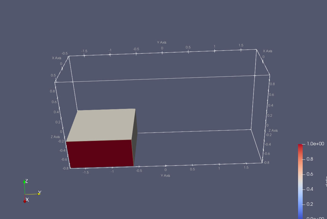

I know this operation, but I actually want to change the scale of the coordinates and the position of the origin, so that the origin is at the intersection of a certain boundary and not in the middle position

Maybe try using Transform filter ?
For example, I want to set the boundary here to start at 0
Could you please tell me where this is
For example, my (0,0,0) is here at the center of the box, and I want to move it to the bottom left corner position ![]()
Filters → Alphabetical → TransformFilter
Thank you, I will try it.
