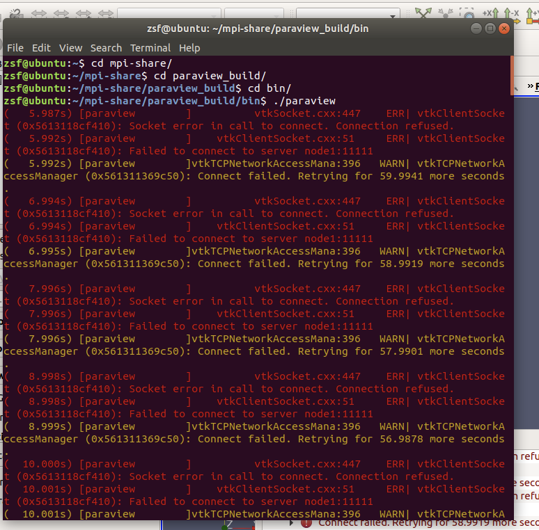

I have made a ParaView server by two virtual machine on a host machine. It is normal when I connect to the server using only one ParaView client. But errors(as follow pic) occured when I connect the server using the second ParaView client. In other words, my server side can’t be connected by more than one ParaView client in the same time.
