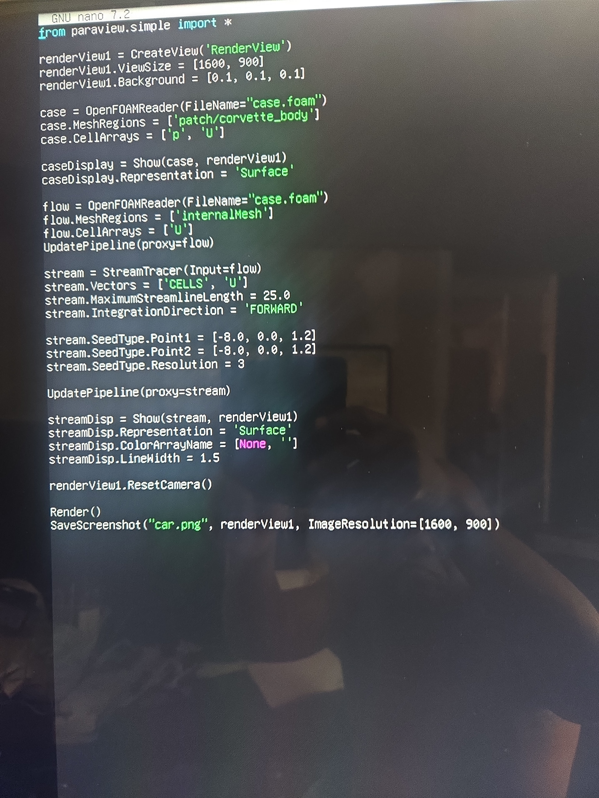

I need help can getting my stream over my car
Im using a Linux headless server,I have to run xvfb-run,cant get the stream to got over the car?

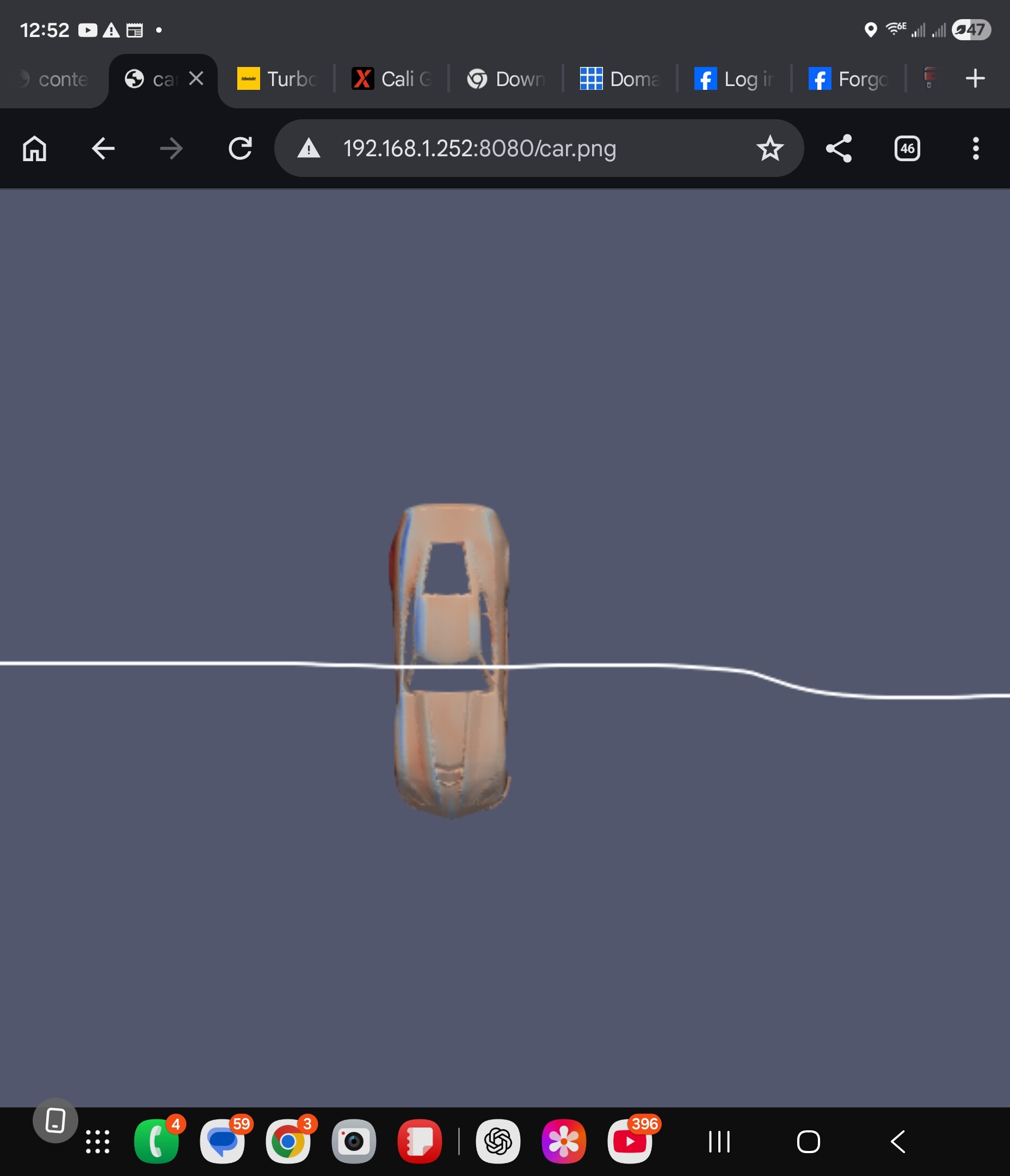

Here is the script and the image it produce,can get them to line up ,any help would be appreciated,.tryed different camera angles still didn’t work.
It’s not clear what you are trying to do. The streamline looks like it is over the car in the image you shared.
I want stream moving over the front bumper, the hood,roof, down the back bumper creating the wake in the back.

I don’t know the OpenFoam reader, but the line case.MeshRegions = ['patch/corvette_body'] makes me think you might only be loading 2d results on the car body instead of the 3d flow around the car.
