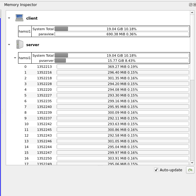

Hello everybody,
I am trying to use Paraview-Superbuild on a HPC cluster to generate an animation via terminal. When I run my batch file, which looks like this:
#!/bin/bash
#SBATCH -p
#SBATCH -A
#SBATCH -J unst
#SBATCH --nodes=1
#SBATCH --ntasks=55
#SBATCH --cpus-per-task=1
#SBATCH -C weka
#SBATCH --time=12:10:00
#SBATCH --output=slurm-%j.out
#SBATCH --error=slurm-%j.err
echo "SLURM_NODELIST $SLURM_NODELIST"
echo "NUMBER OF CORES $SLURM_NTASKS"
module purge
module load comp/gcc/14.1.0
export PATH=/arf/program/cmake-3.31.2/bin:$PATH
export PATH=/arf/program/ParaView/paraview-superbuild/install/bin:$PATH
mpiexec pvbatch --force-offscreen-rendering --verbosity=OFF sample3D.py
sstat -j $SLURM_JOB_ID
I always get the warnings in the picture.
What could be the reason for this and any idea on how to solve it?
These warning are not coming from ParaView, are they coming from slurm maybe ?
Please note this is not running distributed but serially, on a single MPI process
I don’t see a reason why you would need CMake in your path
Ercan
(Ercan Umut)
June 16, 2025, 8:10am
3
Mathieu Westphal (Kitware):
Exactly, they are from slurm. But I guess they are saying that ParaView does not use all of the sources, right? I guess every CPU is used, let’s say, 5% instead of 90% and this creates a warning. I had an screenshot of memory inspector taken some time ago where I had to open ParaView on OpenOnDemand with GUI and it showed something similar. HPC system bans the user due to inefficient use and that would create a lot of hassle for me
How can I make it work distributed? Would it distribute the load all the available CPUs equally? I noticed that task0 takes the main load.
I always put install dependencies in my slurm file, as a habit. Would it affect anything?
mwestphal
(Mathieu Westphal (Kitware))
June 16, 2025, 8:47am
4
mpiexec -np N, where N is the number of cores you want to use, however, in the context of HPC and multi node computation, you may need to generate and use a host file.
