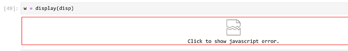

w = display(disp)  # This line giving error/
Everything is working except the last line, which is giving me the following error in all the major browsers.
I have pasted the error below:
[Open Browser Console for more detailed log - Double click to close this message]
Failed to load model class 'PVDisplayModel' from module 'ipyparaview'

I think I ran through this issue when I tried to use ipyparaview some times ago. It seems to be related to the ipywidget version. ipyparaview is not compatible with ipywidget 8.0.0 and beyond, so I downgraded it to 7.1.1 and it worked fine (here is the related issue Issues Rendering on JupyterLab · Issue #40 · NVIDIA/ipyparaview · GitHub).
@jourdain has some scripts that (I think) help with venv usage from at least VTK; maybe then can be adapted for ParaView?
Hi Thomas! Thanks for your inputs! I was having a higher version than 8.0.0. So I tried pip uninstall ipywidgets and then installed a specific version using pip install ipywidgets==7.7.1. Restarted the machine and the server. Still I get the same error.
