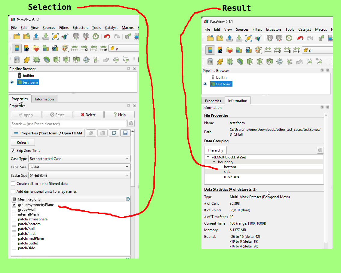

I got the latest version of ParaView (which is 6.1.1), and it has difficulties with the OpenFOAM Foundation v13 results for the Duisburg Test Case Tutorial. For example, if I check the checkbox for “symmetryPlane”, the results that are loaded are “bottom”, “side” and “midPlane”. This is shown in the attached image.
