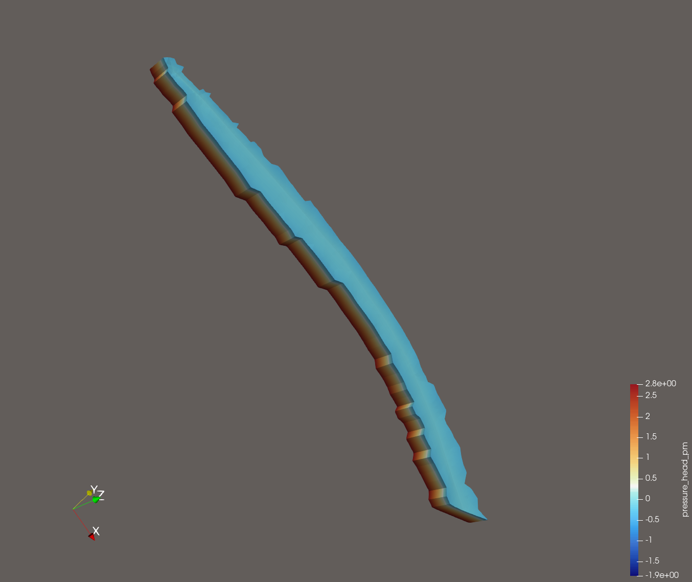

Is this what you want to do ?

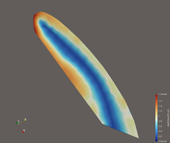

Hi Matthew,
Thanks for your support. So, the first image (depth to groundwater) shows the plan view of an example watershed model. This model has 15 vertical stratified layers (visible in surface with edges view).
So, what I am looking for is that if I can visualize these 15 layers individually. Let us say, if I want to see the components only 12 th layer and not any other layer. How can I do that?
The clip tool or slice tool may help in this case as the terrain is quite flat. But when the terrain is quite undulating how to go about visualizing a particular layer.

Sadly your data is unstructured, which means it does not implictely contains enough information to extract the layer.
If you could generate a field containing the layer ID for each cell, then it would become trivial to extract it.
Yes, thank you! I understood the issue now. Thanks for your help :slight_smile:
