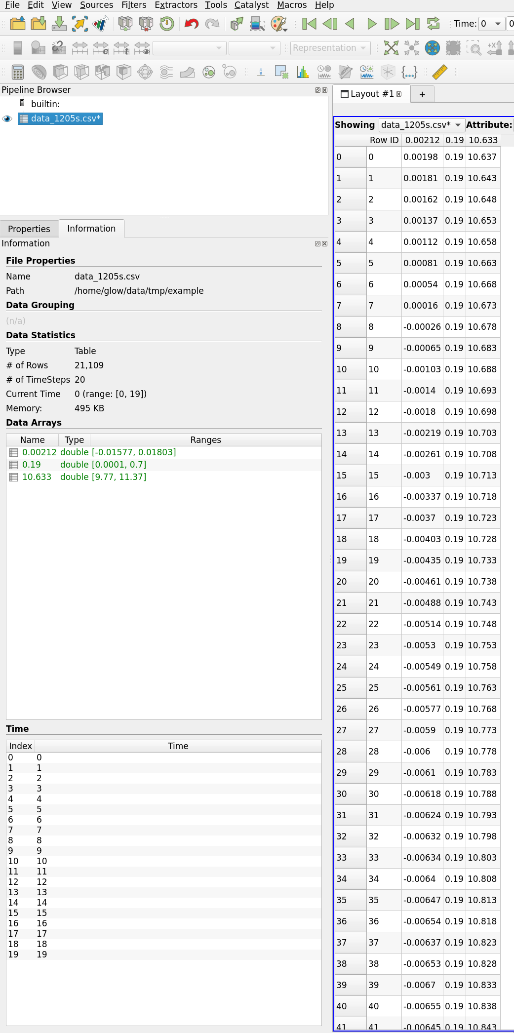

I have sent one example that worked in 4.4.0 but did not work in 5.11.0.
Dear Mathieu,
Thank you for testing this out. It is the status that I expected to load. I tested the data myself by placing it in the Desktop folder and it worked perfectly. The strange thing is that I couldn’t load the data as a group in its original folder location, possibly due to the folder naming format. Nevertheless, I’m relieved that it works now. Thank you once again.
