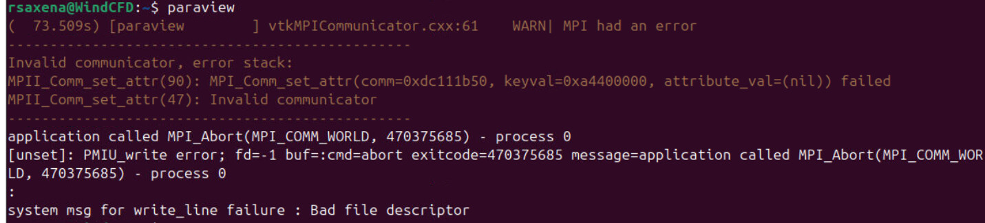

Hello,
I have Paraview 6.0.0 installed on my machine running Ubuntu 24.04.
The GUI opens nicely, but when I try loading Exodus II (*.e) files, Paraview crashes with the following error message (see attached screenshot).
This same error occurs whether I use the IOSS reader or the Legacy Exodus II Reader.
The same exact Exodus files load just fine in Paraview on my Windows machine, so I know it’s not a problem of corrupt data files.
Thoughts?

4
It loads fine on my mac with master built locally and on my ubuntu 24 with master built locally and the 6.0.0 binary. Are you using mpi if yes, how?
mwestphal
(Mathieu Westphal (Kitware))
5
How did you install ParaView @rsaxena ?
