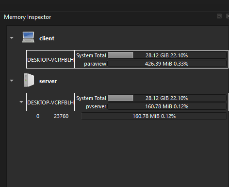

I’m testing this on my local machine (windows 11). Also after making the connection using paraview GUI, under memory inspector tab, only one processor is connected.

Client connected.
On the Paraview memory inspector:
