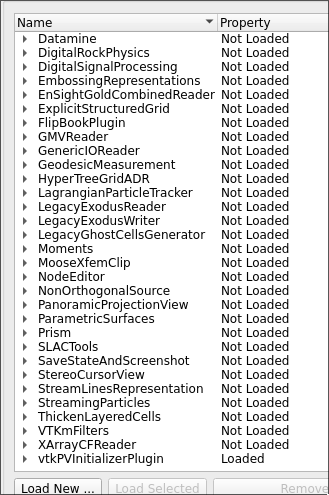

I’m trying to use paraview 6.0.0 on my NixOS machine, which is available in the unstable channel of nixpks, because I want to visualize code-aster results file. Unfortunatly I can’t see the MEDReader plugin in the plugin manager.

The MEDReader is an external plugin that is not part of ParaView source code but is from the Salome project.
It is packaged in our binary release thanks to our superbuild (basically a package manager) but the logic would have to be replicated by NixOS to be able to offer it in their build.
If you want to use it, just download our binary relase from https://www.paraview.org/download/
