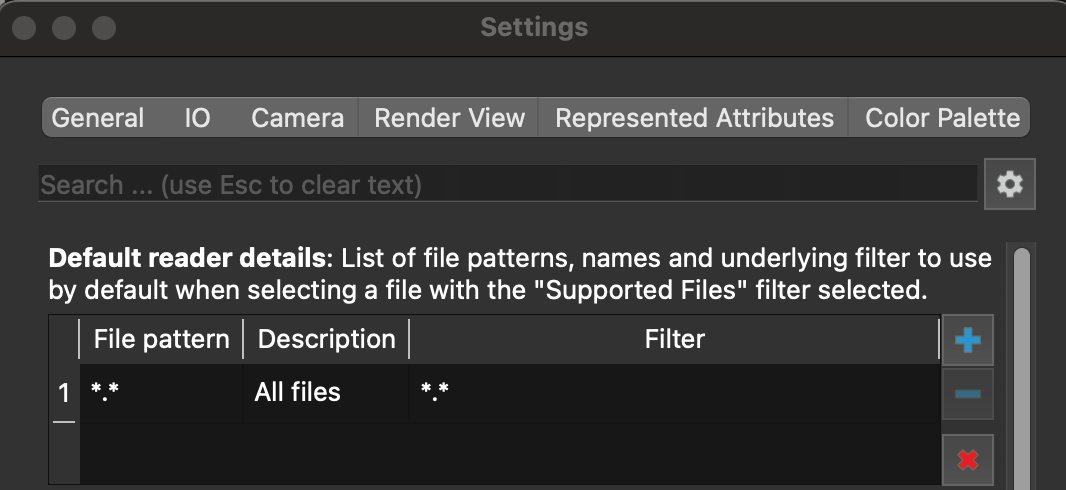

Thank you, @deanwormer . I was able to reproduce your observed error by using the settings files you included here. The offending section of the ParaView-Settings.json file that led to the problem was
                "IOSettings" :
                        "ReaderDetails" :
                                "All files",
which you can get if you manually set these IO settings in the ParaView Settings:
Do you recall if you set that setting manually? Or did you do something else like save the default reader to use when you were presented with a few reader options to open the .nc file? Thanks!
