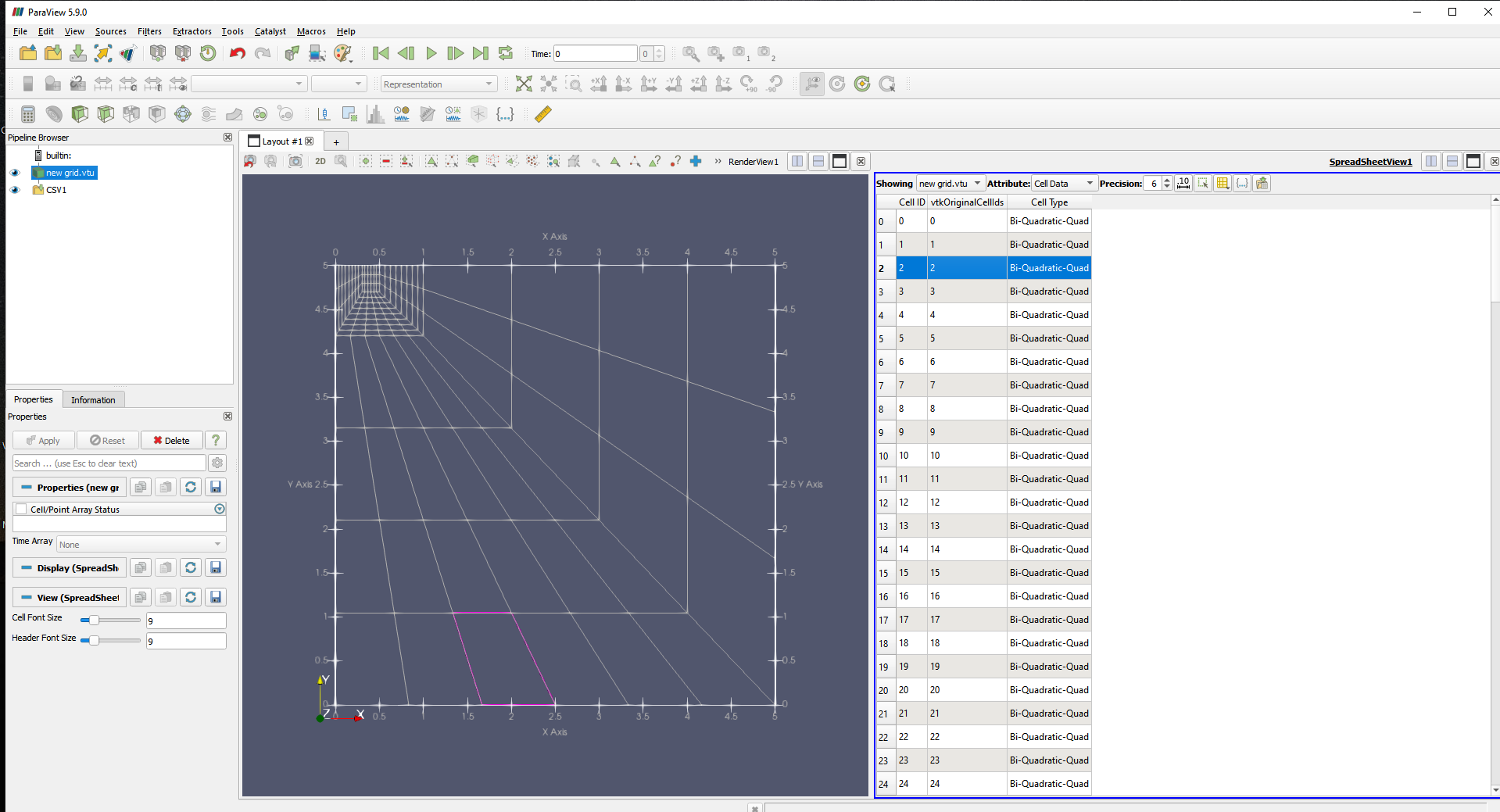

Hello friends this is my first post. I am trying to view the nodes and elements numbers of a 2d mesh. Earlier I was successful in doing that. see picture below, but now when I am trying to do it I am unable to do so, Maybe I am missing some settings. Could you please help.

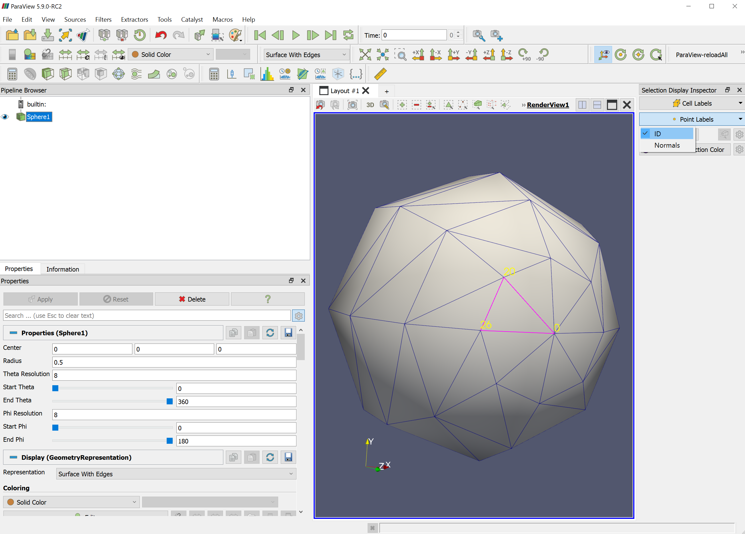

You need to select the point label id in the Selection Display Inspector (menu View).
Example:
Hope this helps,
Joachim
