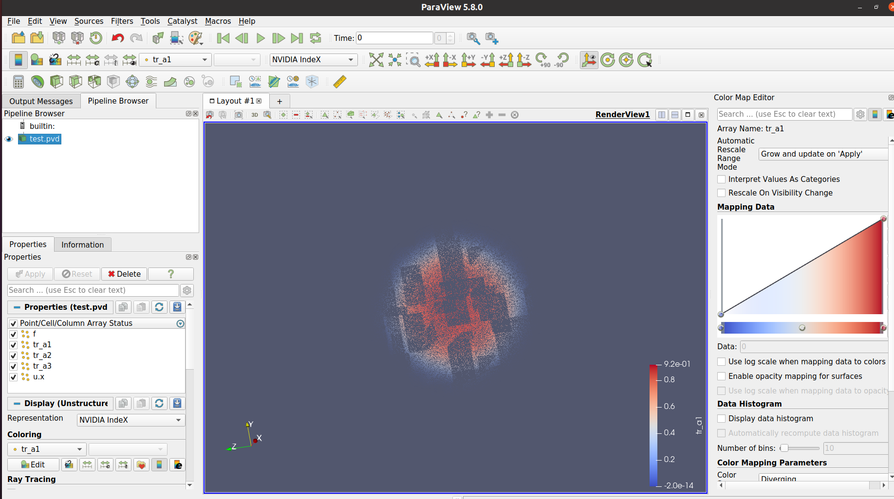

Thanks, Alankar. I tried but it didn’t work for me.
Below is the result using your trick.
