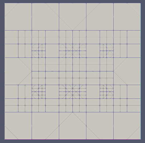

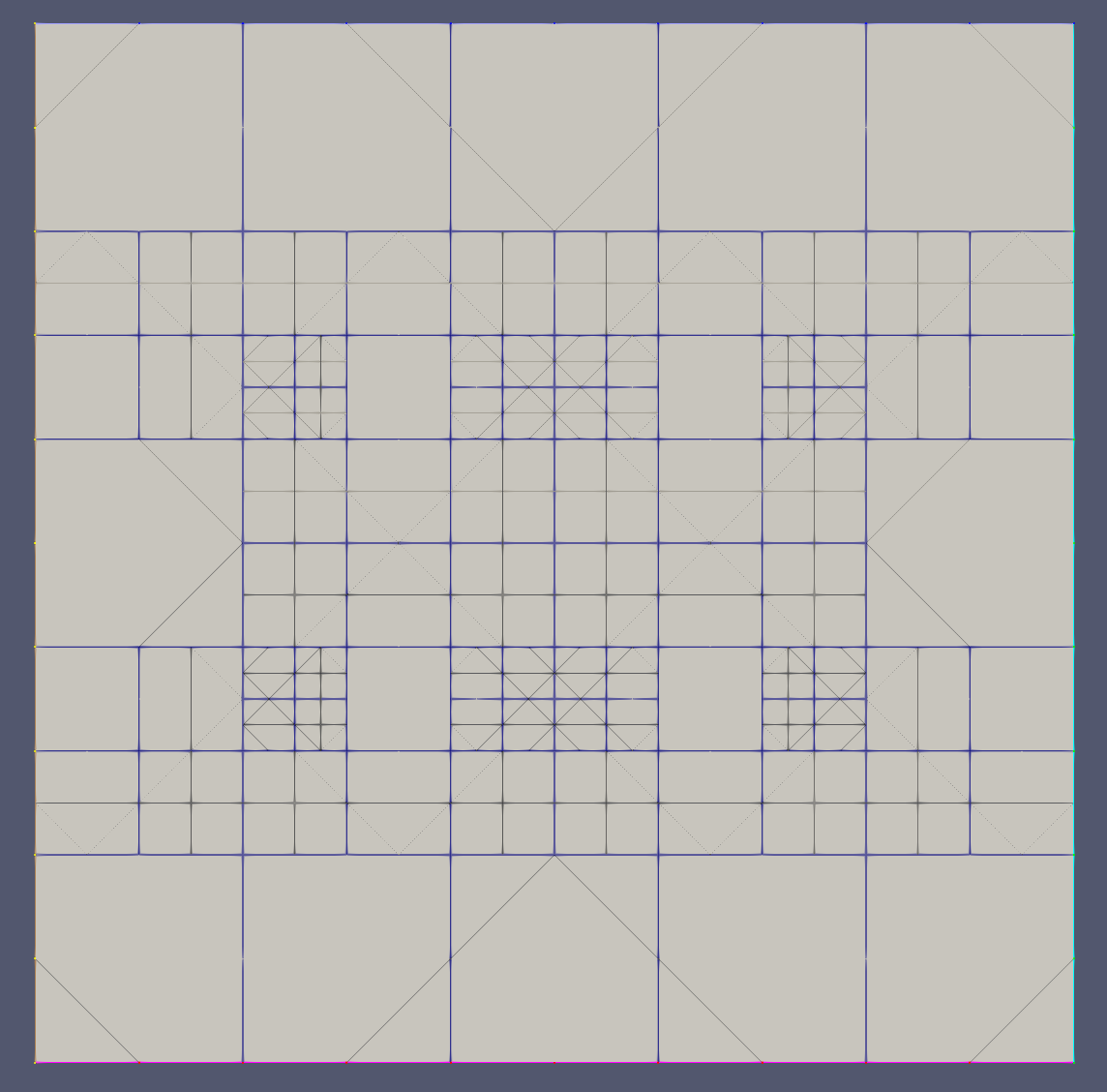

Odd appearance of Surface With Edges
Can anyone help us understand what might be causing this render to look wrong?

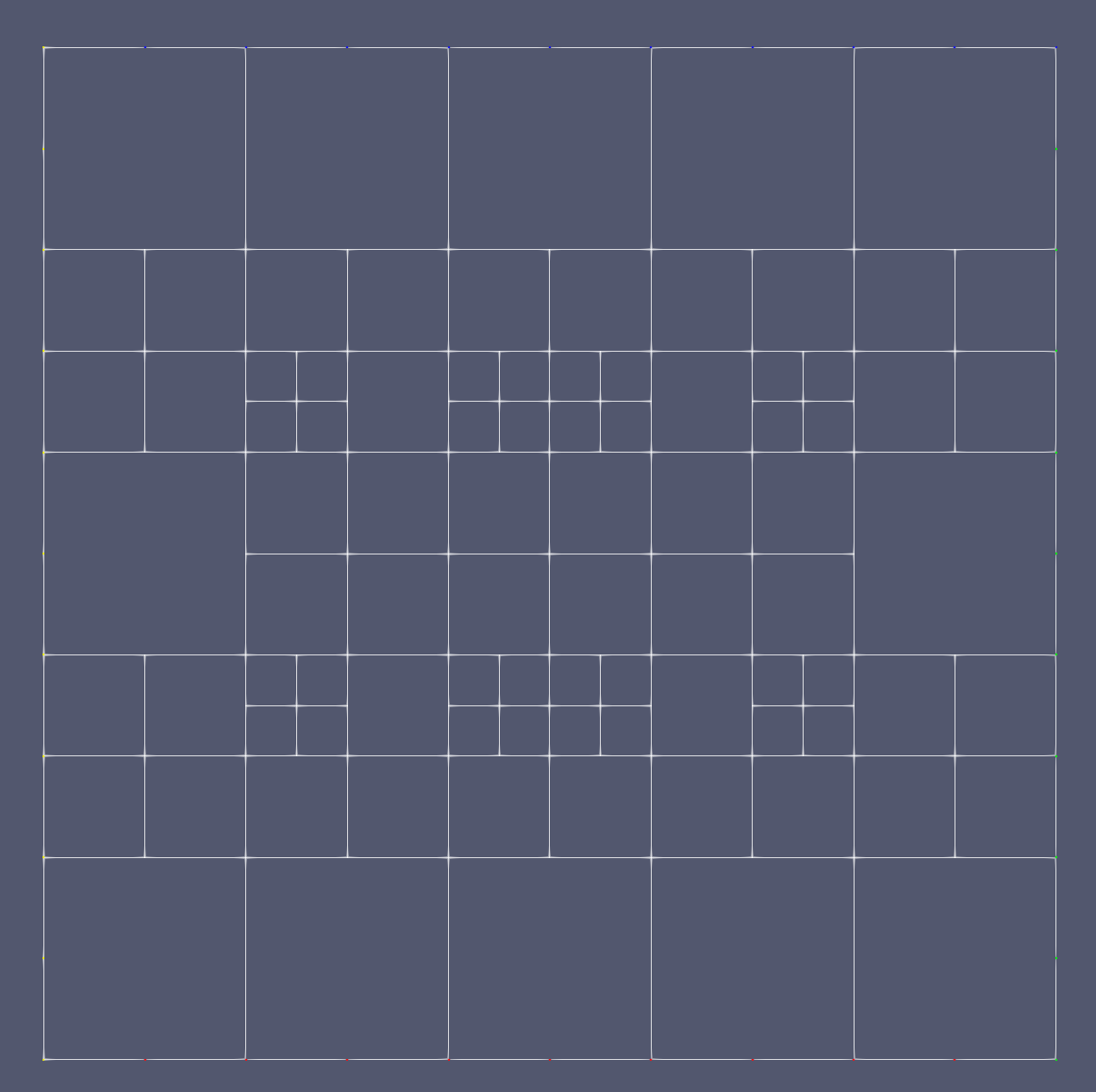

The expected appearance is more in line with what the wireframe produces:
Is this on a Mac?
This looks like https://gitlab.kitware.com/paraview/paraview/-/issues/22636.
Yes, it’s a Mac. That seems the likely explanation.
Try turning off “triangulate” option in the properties menu.
