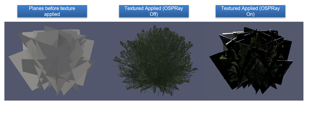

Loading it into PV and applying it as a PBR texture works fine, although it breaks when OSPRay is turned on. OSPRay is still rendering the parts of the plane even though it should have 0 opacity, see picture below.

Note that the bug is most likely in VTK, not OSPRay. I’m sure that translucent textures were supported at some point.

Please do file (or search for and then file since this sounds familiar) a bug regarding opacity. I agree with @Michael that the problem is most likely in VTK’s mapping to OSPRay calls.
