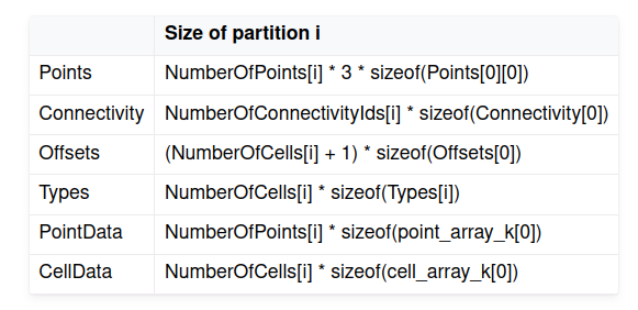

Everything when we talk about “partition” is for the parallel support : VTKHDF format specification - VTK documentation
Some dataset will be of size N where N is the number of partition, like `NumberOfCells` …

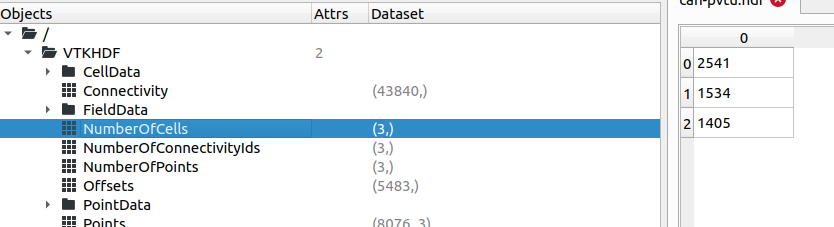

If we take as example the can-pvtu.hdf dataset :
`NumberOfCells` size is equal to 3, meaning that this dataset is partitioned in 3 parts, first part has 2541 cells etc…
Then some other datasets will reuse these information:
like `CellData`, which will read for the first part only the 2541 first values and so on.
