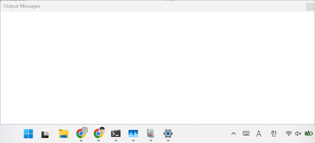

Image attached: Paraview shows this window from right after I click the icon, and after a few seconds the window(still looks like image) disappears(auto-closes) and one more crash log at eventvwr.
There’s no brief moment of real paraview window.
