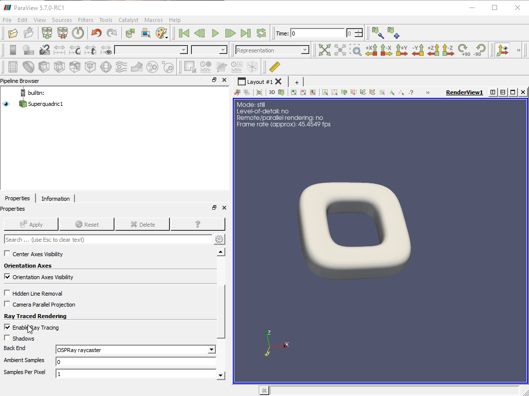

I just installed 5.7.0-RC1 and was playing around with it when I noticed the following:
it looks like enabling Ray Tracing causes some funny behaviours with objects that have handles.
For instance, if I have an object and I want to measure it, I’ll use the ruler.
  • without ray tracing, everything works properly, I can drag the line or the ends of the arrow.
  • with ray tracing on, it’s pretty hard to place it as it travels much further than expected and grows like the Hulk:
    I guess there’s no point in having a raytraced ruler but maybe this has other consequences.
Another example is if I apply a transform filter on an object:
  • without ray tracing, I can drag the handles to move the box around.
  • with ray tracing on, the box disappears but I can still drag the invisible box.
Like the Hulk eh? :slight_smile:
