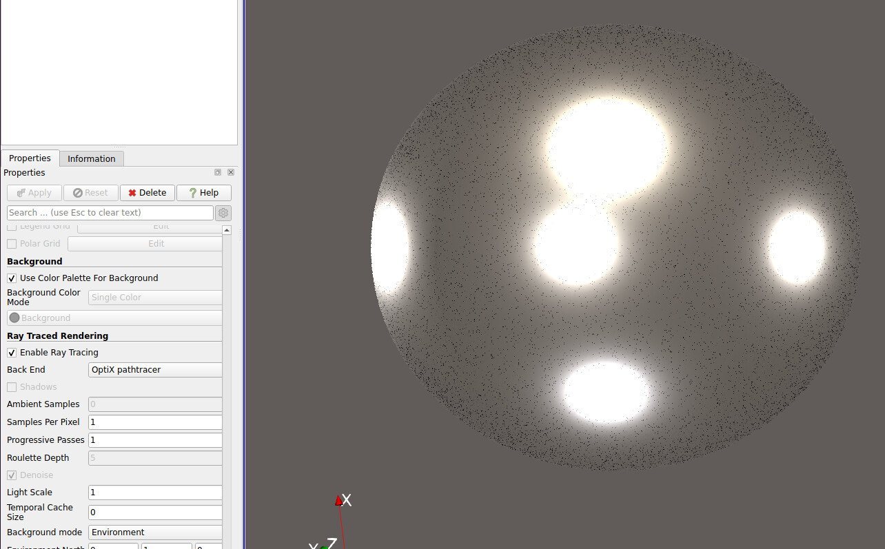

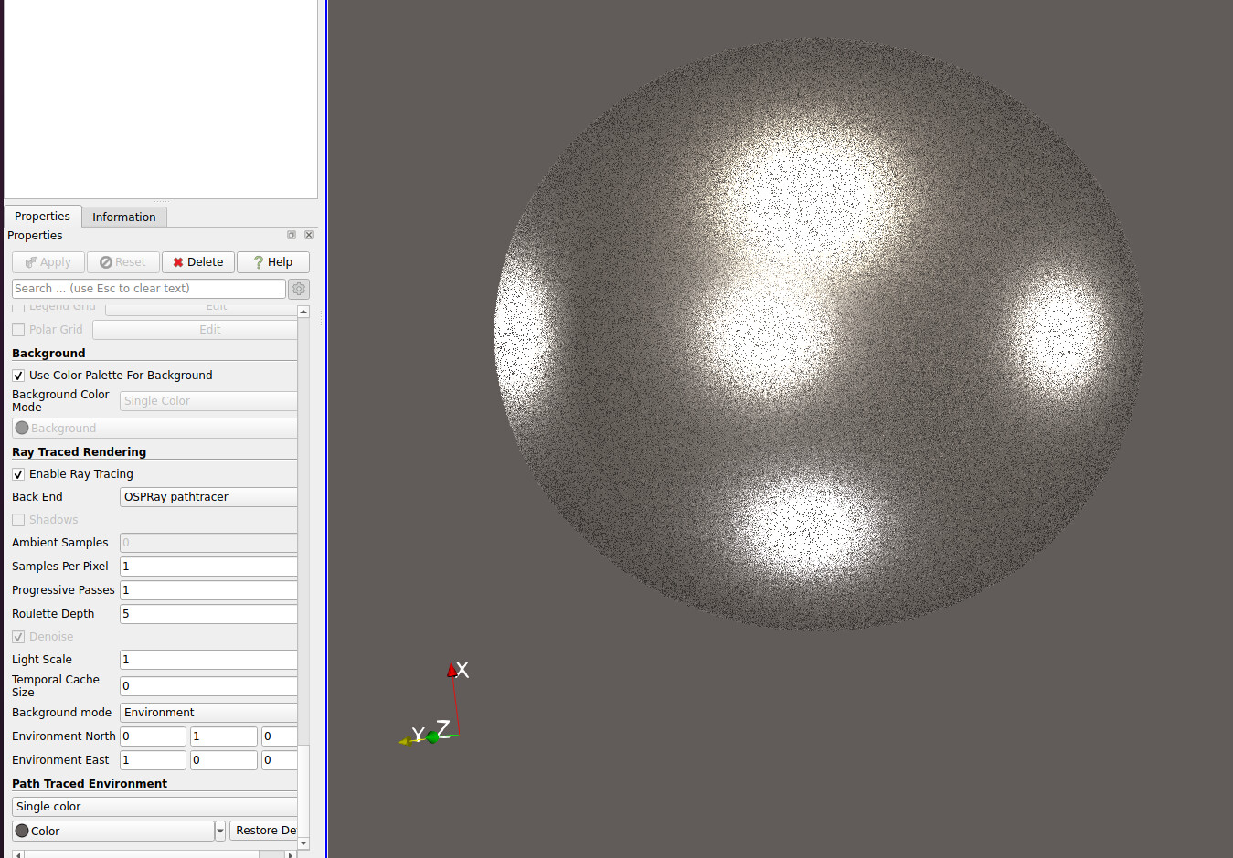

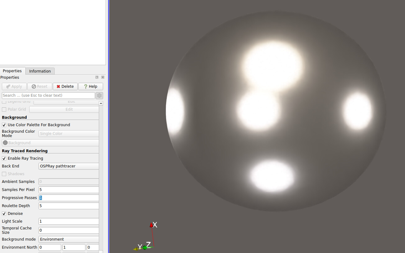

With the OSPray pathtracer it works fine, here I have an sphere with 1 sample per pixel
And here 5 samples per pixel
However with the Optix pathtracer, it works fine with 1-2 samples per pixel but if I increase it beyond 3 samples to increase the quality, it crashes with the error mentioned above.

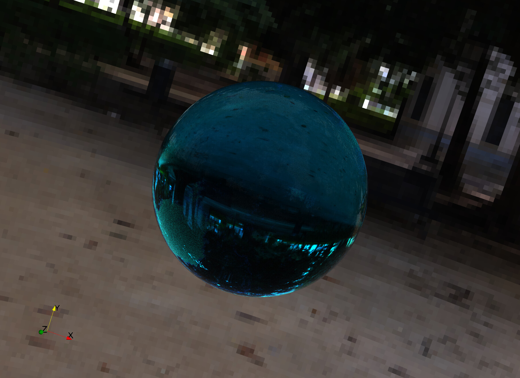

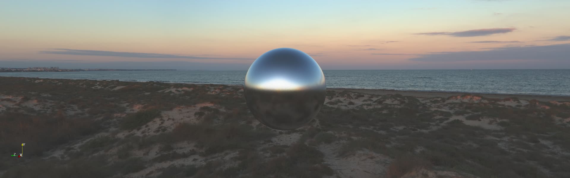

Unable to reproduce, works fine here (40 samples, denoise, material, env lighting):
Would it be possible to record a .py so I can have the same exact set up? I am very puzzled that it doesn’t work the same way if the only modifications were samples, denoise, material and env lighting :frowning:
