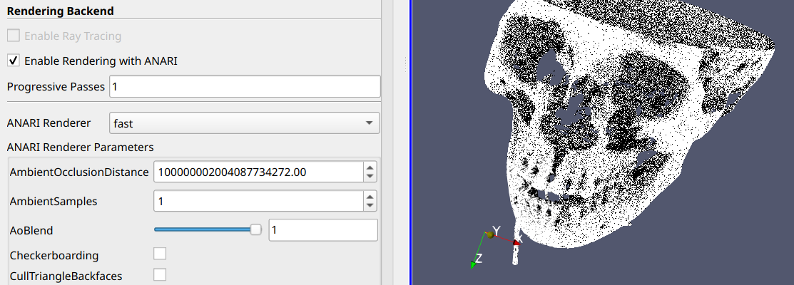

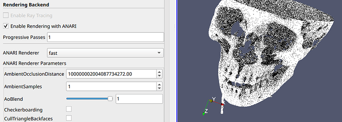

And while looking at the available ANARI options it seems to be based on visrtx (based on warnings about unsupported features), which thankfully seems to be included in the binaries. But is missing from the docs.

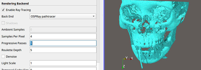

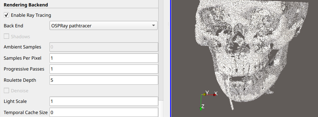

The OSPRay pathtracer seems to be broken, as increasing samples per pixel turns the rendered object blue (and I vaguely remember seeing this before, but can’t find any bug report):

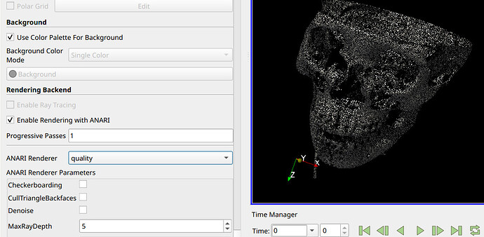

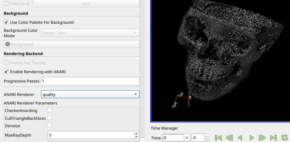

When trying out ANARI the quality option seems to ignore the background color set (or at least turns it black):

Regarding the OSPRay path tracer issue, this is a known bug reported here: https://gitlab.kitware.com/paraview/paraview/-/work_items/23404. Please follow that issue for updates as work toward a fix progresses.

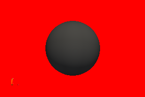

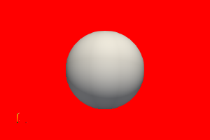

With regards to the background color in ANARI VisRTX “quality” mode, I think it is either a bug in ParaView or the version of VisRTX that was shipped with ParaView 6.2.0. I verified locally that the background is properly rendered in quality mode with the latest anari-sdk and visrtx. See the image below. I’ll dig into this further and report back.
OpenGL
ANARI + VisRTX “quality” renderer
