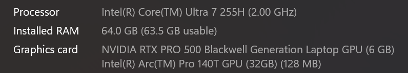

P.S. here are my PC specs

As an additional note, my PC uses about half of my memory (30GB/64GB) so I hope it is not a hardware issue. For reference, here are some cases when I encounter sudden crashes:

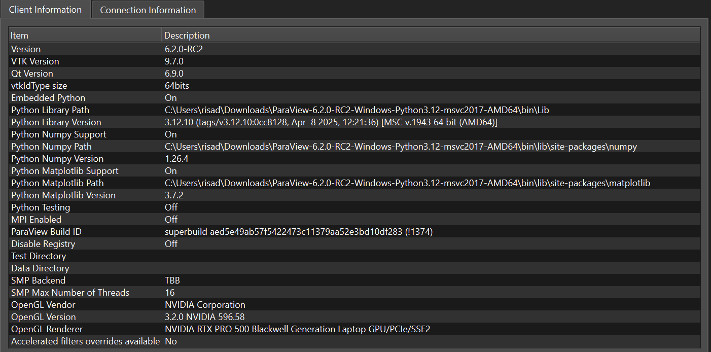

Please share Help → About dialog content.
Here is the current dialog content
Looking at your screenshot you are using 100% of your GPU but there is no info about your VRAM. I doubt that you are actually running out of that cosidering you have 6 Gb of it.
